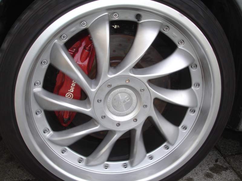

I'm running evo 8 calipers, you need a conversion bracket as they are bigger than 350 brembos, I love mine prob cost me 600 in all
Got an evo set up myself. Just gotta fit em bud!! Good price!
[sIGPIC][/sIGPIC]
bracket wise some dude on dw can make them, cant remember his user name but search in items for sale for evo brembo brakes and im sure you will be able to stalk him a bit, mine are set up from 350z brembo caliper fitment discs, think his calipers use evo discs

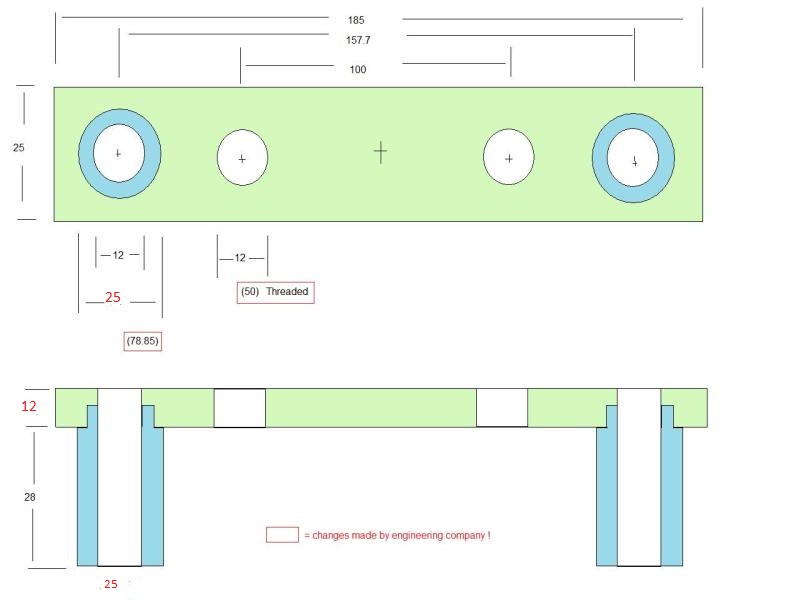

I used EVO calipers with 350Z discs on project 1, I'm sure I have a drawing of the bracket somewhere, I'll have to have a look.
Yeh I've got EVO's on mine, I have the bracket template on my pc, I will dig it out and post it up when I get home ;)

Another option are skyline brembos, they fit straight on with no brackets needed, the difference in size between stock and evos are massive and the stopping power is immense,not sure on d2s, they are meant to be good, lots of calipers fit, porche, Aston but all need the conversion brackets ;)
I went for 350z Track Edition Brembo calipers and 324mm discs off the same.Only mod was drilling the caliper bolt holes out from the standard zed 12mm to 14mm to take thicker 350z caliper bolts...no tatting about with brackets and my existing brakelines fitted straight on :)
