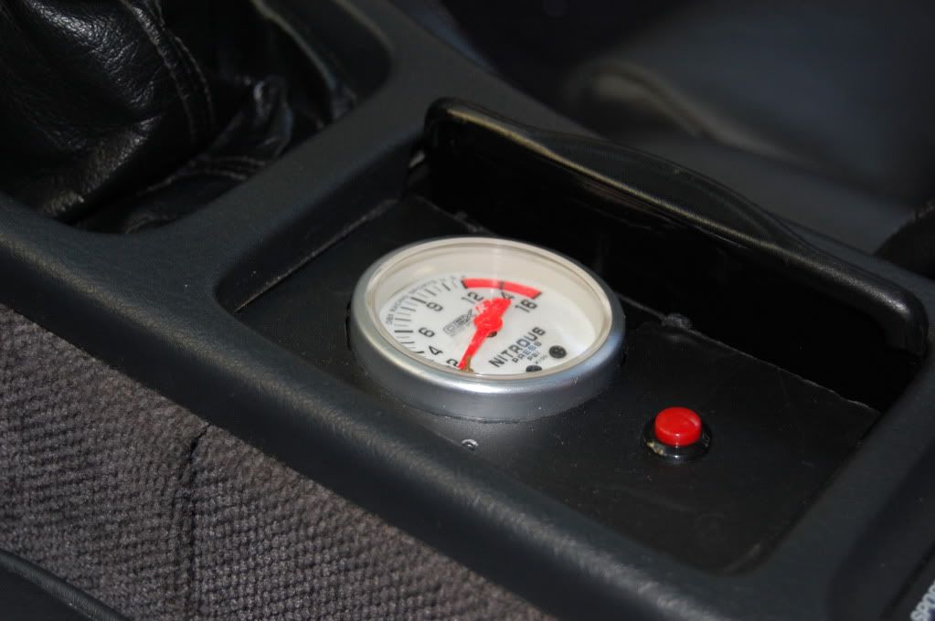

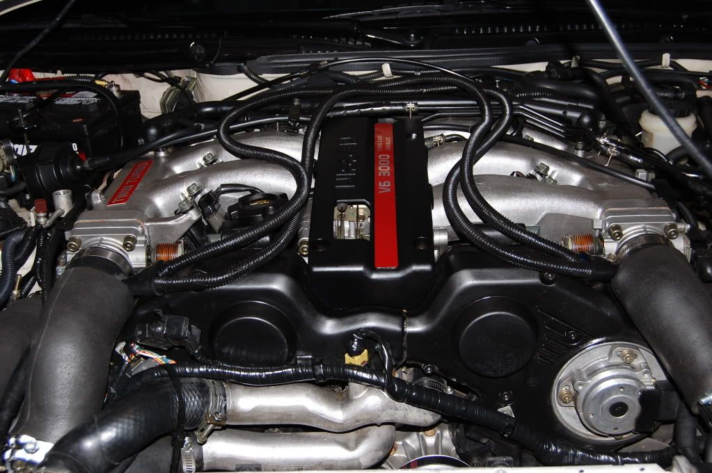

Here are a few pictures of the Z. I need to get a few better pictures done. These are pretty bad. The second one you can see the nitrous lines on top of the intake plenum with the braided hoses covered with black insulation to help it blend in with the rest of the engine bay. Kind of going for that stealth look...lol. In the third picture is my nitrous pressure gauge and purge button I installed in the ash tray bin.
