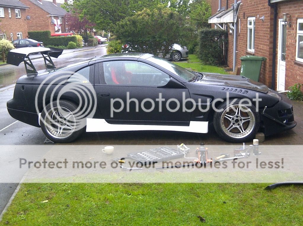

the white Volks are 18's and are decent enough (9j/10j ET +45) and sit pretty well but I wanted something with a lip and preferably 17's as the local tyre supplier get's a lot more 17" part worns than 18"
so I did a deal with reeperR32 on Driftworks for his 17's

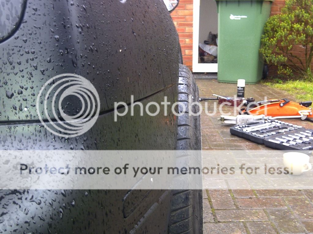

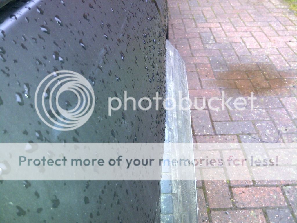

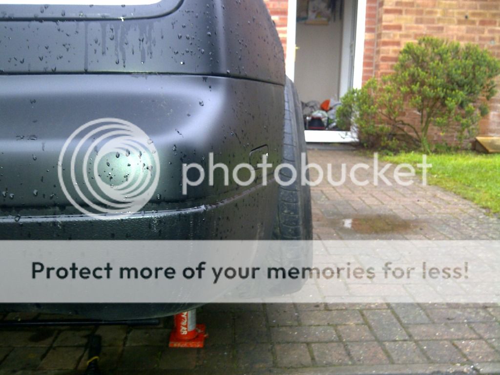

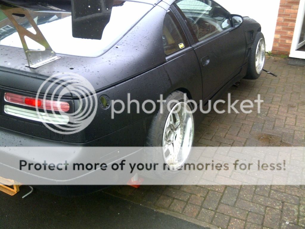

I knew that being ET -7 they were going to take a bit of adjusting to get in the arches. A bit of camber on the front (9j's) sorted them but the rear arches on Z32's are lame and as expected the rear rim lip (10j) sits a good 50mm outside the arch, with the edge of the tread sitting approx 25-30mm outside the arch.
I figured that I'd do the same with the rear, bring the camber in and maybe flare the arch....but there's no more camber to play with and I don't think that I'll get enough of a flare to make up the difference
It stands to reason that going for an ideal offset/width would have been the wisest move but I'm sure that there'll be some way of getting them sitting right. Preferably without having to go down the wide arch route purely because there's fook' all available for a SWB Z32
the other minor issue is that the front rims sit a bit further forward than previosuly, now I put this down to the fact that I've replaced all the stock components with DW adjustable kit and it hasn't gone for a wheel alignment yet but I want to get it in the general area before taking it down. What part needs adjusting to bring the front wheels back slightly so that they sit closer to the centre of the arch?

Re: front, the tension rods need adjusting to bring the wheel back a bit (you'll be reducing the castor)
Re:Rear, more stretch on the tyre and a flare should see you good, you can do the flare with a jack handle and a mate to drive it forward and back, and by the looks of your paint you won't need to bother heating it up to prevent cracking you could just sand it back and rattle over the top!

I figured that it would most likely be the tension rod that was the issue, because I didn't have the problem the other week when I fitted the regular DW tension rods, it was only when I fit the DW Geomaster type (that are deliberately bent) that the problem arose :thumbup1:

You could elongate the holes in the subframe and the top link mounting holes,to allow more camber and a scaffold tube would be better to flare the arch, seen this done on youtube.

Yeah scaffold tube would be good, I happen to have a nice chunky proper jack handle that does a good job....wouldn't use one of those little 'fisher price my first jack' type handle lolz. Got good smooth results on both my bimmer and the Z doing this.

all of the tyres for the rear vary between 235-255, the arches are rolled and now need to be flared however a bit of negative camber is required in order for the tyre to tuck under the arch when it's lowered a tad more

I cannot see how you would get them to fit unless you have a mega camber. but with the stretched tyre you will be putting a hell of a lot of pressure to the inside tyre wall. I would go for some sort of wide arch. get some universal ones that bolt on.

Yeah, I kind of figured that a wide arch would be needed. I popped down to see a mate this afternoon; he runs a garage in Hereford with his son. They put me in touch with a metal fabricator not too far from my place and after speaking with them on the phone, they reckon that they can sort the arches and fab some metal flares so that I can keep the lines looking fairly natural.

after a few lower arm adjustments it's looking better already. I've ordered an arch roller so that I can flare the arches..

just a tip with flaring the archs .... Warm the Metal up with Heat gun ... if u didnt all ready know thats is ..

lol you got some work to do then .. as thats quite a lot bending its that much u may find your paint may crack

Dont get the paint to hot or it will blister and that will be a real pita to sort out.

1/2 degree of negative camber on the rear and just about to lower it by another 25mm (it's on bricks at the moment)
you'll need to do your camber again after you lower it ....
