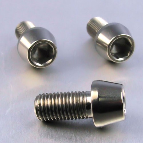

found these... a bit long I know but that can be fixed....
http://www.pro-bolt.com/index.php/titanium-socket-cap-m10-x-1-25mm-x-20mm.html#.T5edfnmndYR
Titanium Socket Cap M10 x (1.25mm) x 20mm
£6.12 Inc VAT
£3 delivery
So £15.24 for two…
