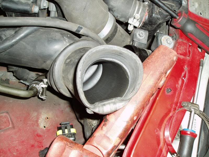

Boost leaks are part and parcel of zed ownership and one of the most common causes of erratic running issues.

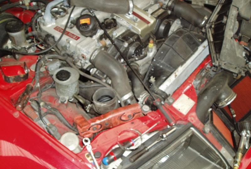

When refitting any hard pipes its essential they make good sound seal and are fully tightened up, the turbo side pipes are very often the culprits but on this particular occasion ot was the outer intercooler to turbo pipe that had been fitted wrongly at some time.

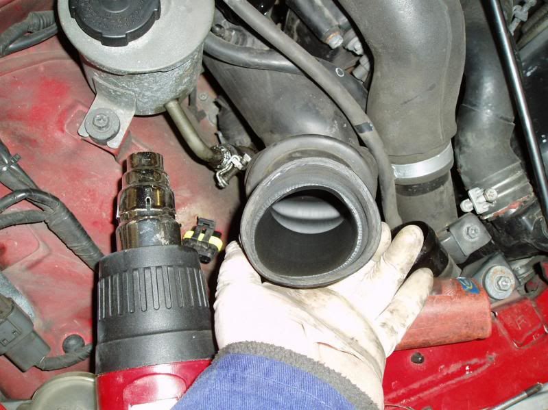

The faulty fitting had inverted the rubber pipe into the steel section and was causing a massive leak, the pipe been semi hard rubber needed to be warmed for a few seconds with a heat gun to return its former shape before refitting, and soon all was as it should be.

would say thats easy to do knowing how hard it is to get that pipe in fitted right ..
was it even clamped up on the inlet pipe ?
Yes it is a pain to get into place, the clamp was tight but not that it did any good.
Jeff
Wouldn't you feel that the pipe hadn't gone on correctly? When I did mine, I used the concertina effect of the middle to ensure it went on properly.
