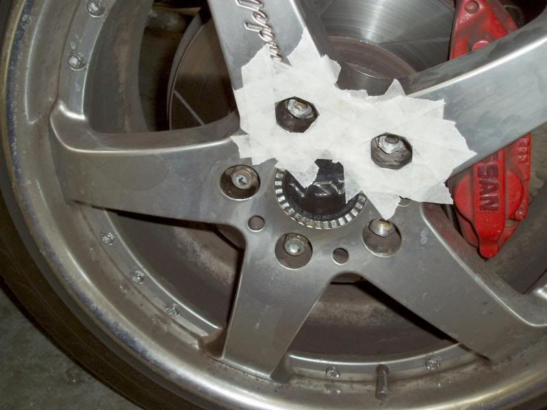

Had a zed in whilst the owner waited for us to look at a nosiy front suspension, the car had been looked at previously at another garage and the wheels removed and refitted.
Unfortunately they had clearly used an air gun to tighten the wheel nuts, they were solid! managed to coax three off but two were not for budging.

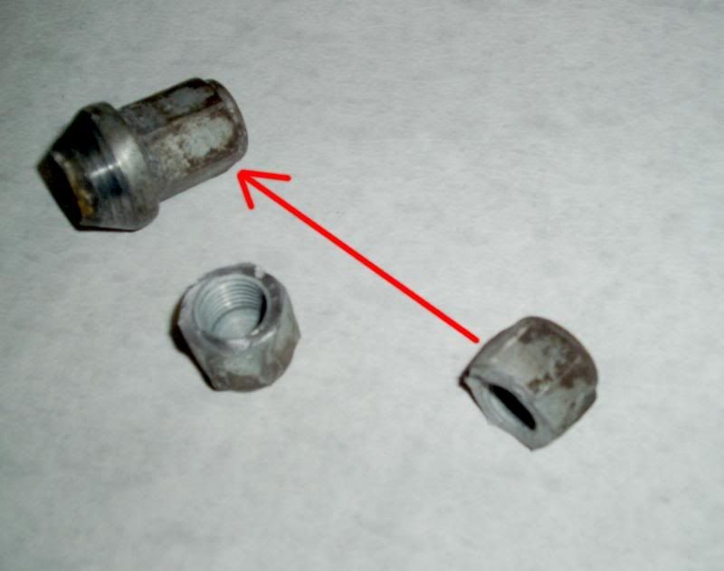

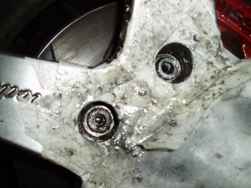

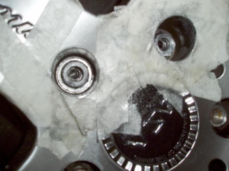

Eventually with the largest breaker bar we had the nuts sheered off! not good but at least we had access to drill them out then, 2 hours to be honest of a ball ache job, the main issue to not damage the alloys.

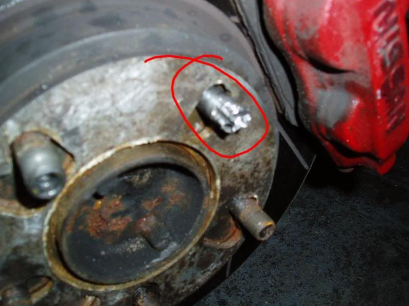

After they were released we had to refit new studs which was the easy bit, once done all was as it should be but what a pain just because of a silly mistake with an air gun.
