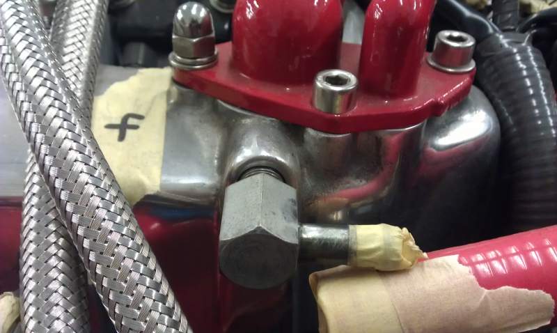

Hi on the passenger side of the plenum I'm trying to work out what all the take off plumb in to.
Can anyone help with this 1?
Ps it may be facing the wrong way.
I thought the smaller 1 further back goes to the fuel regulator there is 2. In using a Nismo fpr now
Your correct mate. That one your on about should point to the front of your car. i think it connects to one of your hard pipes iirc?
yeah your right lee :lol:
He has put the wrong connector in there. thats the cunky one that should go near the front of the plenum that goes to the hard pipes. The skinny adapter should go into there, then goes to his AIV's then to his fpr.
So we were both right :biggrin:
Actually it goes to the PRVR :smartass: :lol:
Im still lost lol. Ok ive got the adaptors round the wrong way. So the chunky 1 connects to my FPR and the tiny 1 goes to the PRVR? What is that in simple terms?
Thanks Dan
Have a look at the Vacuum diagram in the FAQ section mate, all will become clear....
