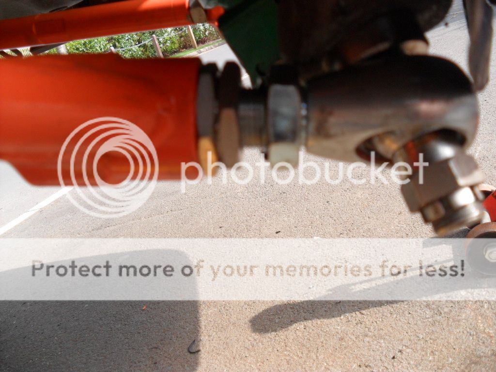

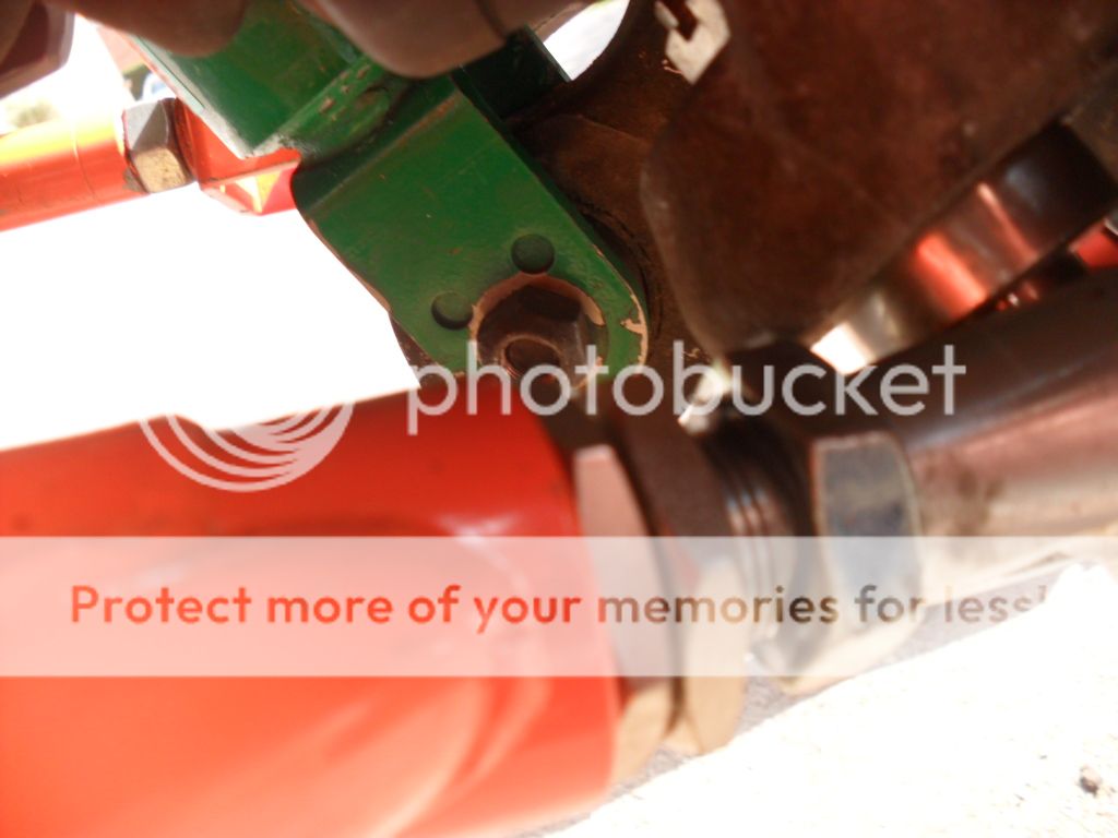

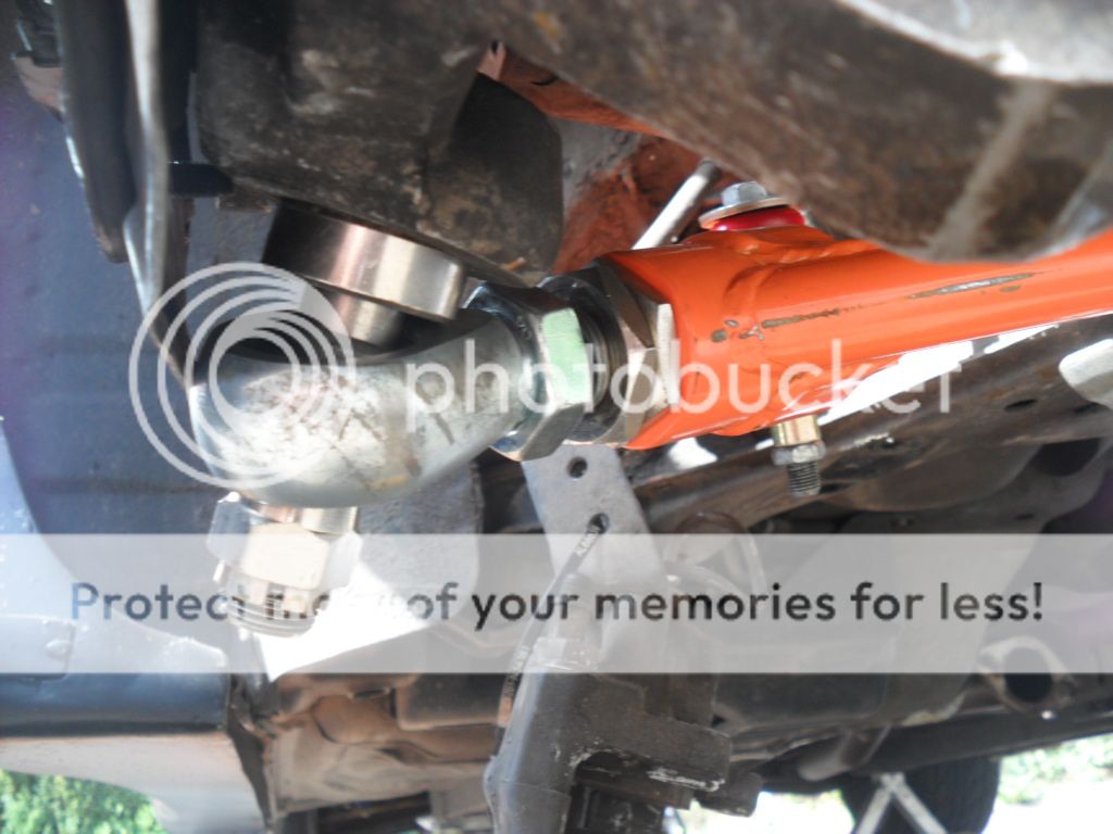

Anyway this is how I've fitted it:
Shorter pin with thicker thread (large nut) at the bottom/thinner thread (smaller nut) at the top

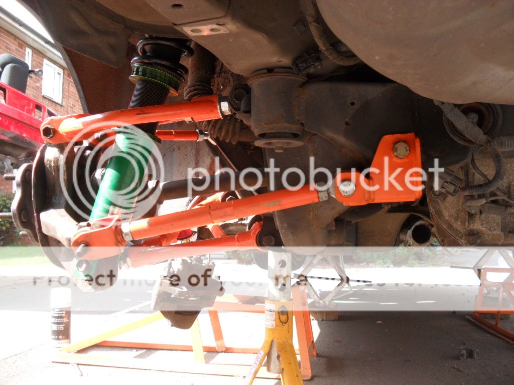

the only problem is that's my old LWB build thread off Driftworks from a few years ago, when I first test fitted them using a bit of a trial, error and guesswork
I ended up stripping them off because (1) I couldn't get a difinitive answer as to how the lower joints were supposed to be fitted to the hub and (2) I kinda' knew back then that the red zed was a bit of a money pit and not likely to get finished anytime soon
I think I've got it cracked now though, fingers crossed
I've even managed to get the wheel alignment (visually at least) spot on, whereas a certain zed specialist who are no longer about managed to balls that one up aswell
