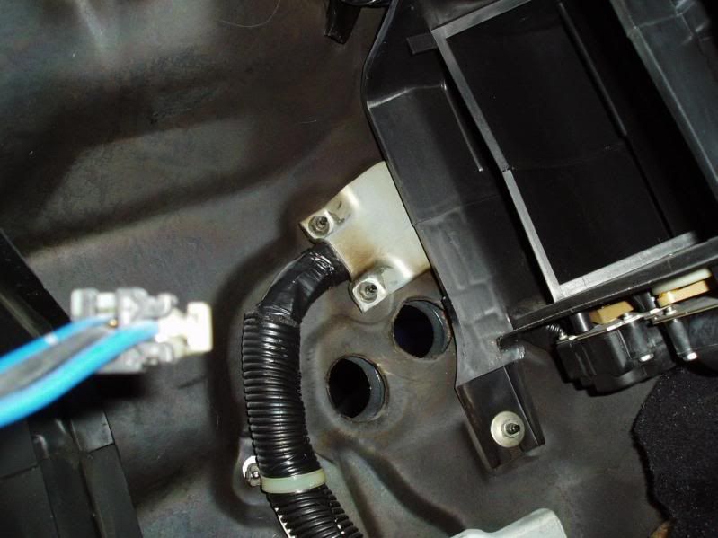

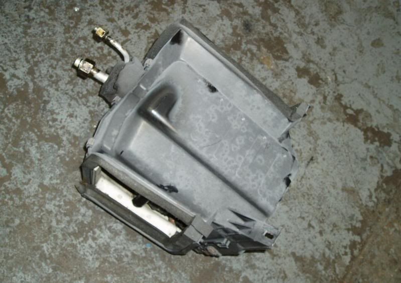

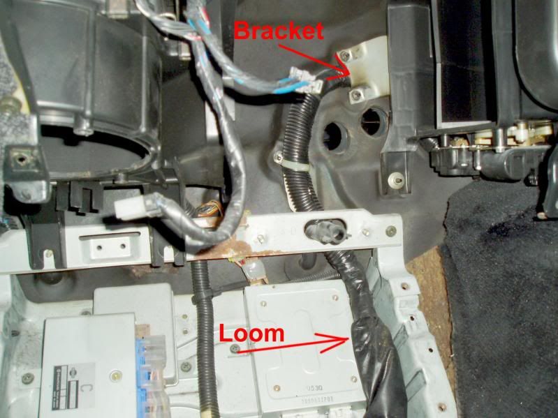

The engine part of the loom is a case of carefully disconnecting and pealing back unit all is undone, however where the loom goes through the bulhead is a different matter, there is a bracket/ retainer that must be undone from inside and the heater/air con unit needs removing for this.

Cheers Jeff, the link boldy posted up has some pics of the bracket and what to remove. Feeling a lot more confident about it now.
A few pics of when I changed a loom a few weeks back.
