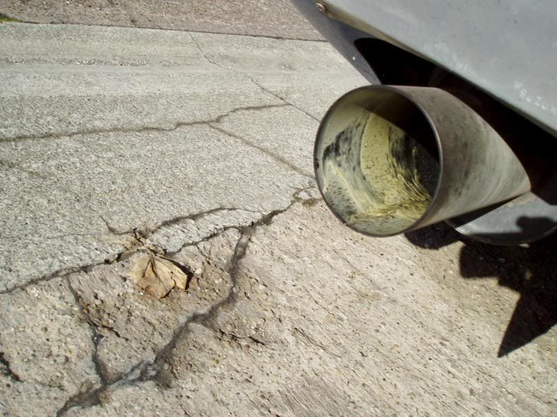

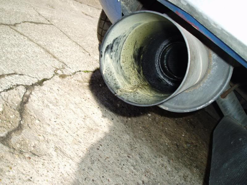

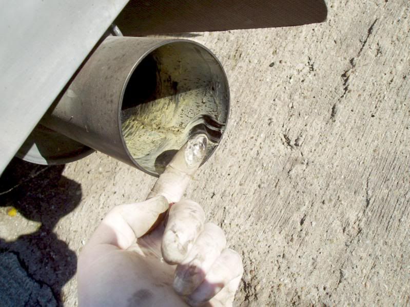

As some of you already know I bought my car with an overfuelling problem. Since I bought it, it has been sitting for 3 months at my girlfriends parents place awaiting me to start on it, all I have done before today is filled with fresh oil and replaced the spark plugs with some more NGK's and fired it up, it sounded fine all the way up to temp with a heavily smoking exhaust and revved freely. The only sound that caused concern was the turbine rattling in the housing that Jeff identified when he looked at it for the previous owner.
Today I chucked 10 litres of fuel in it and fired it up. It chugged away with smoke puffing out the exhaust, the more gas the more smoke have a look at the video I made, it didn't sound to special today but the echo in the shed makes it sound even worse on the video... http://youtu.be/Gk6X5NPYcgg
Today however it did not rev freely it struggled. The temp gauge did not work and neither did the fuel gauge. I let it warm until I heard the choke come off, all the time it was sounding more and more lumpy then I went inside and came out again just as it died. I fired it up again and there was poor throttle response. It had been running 10-15 mins so I did my compression test, the results as follows.
Cylinder 5 = 161 Cylinder 6 = 160
Cylinder 3 = 158 Cylinder 4 = 159
Cylinder 1 = 160 Cylinder 2 = 165
So a range of 7 psi and all within the Nissan workshop manual limits. When I took the plugs out they were badly sooted just from that warm up which I think may have been why it got worse.

"Lorenzo unfortunately had a major issue with coolant mixing with the engine oil, this fills no 4 cylinder with water and also has runined at least one turbo bearing, when drained there was around 3 litres of water in with the oil.
We did have it running at one point but the smoke from the passenger exhaust was extream, hell of a lot of zed there.
Good luck matey
Jeff "

Yes thats right, the petrol in the sump is from the massive overfueling getting past the rings, but water is getting into number 4 cylinder also, bear in mind we had this running good enough to drive on the road at one point, but the water and fueling issue was so severe that when switched off re-starting was a nightmare.
Eggs my advice would be get the engine out of the car and asses the turbos, but expect to be changing an engine to be honest, quickest and easiest solution and most likely the cheapest.
Agreed, if this route had been taken the car would have been fixed months ago.
