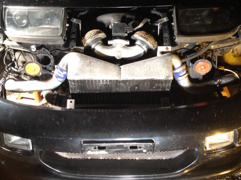

Hi all need some advise on fitting my 99spec front as my front mount intercooler hits the bumper first how have over people done there's if they have at all
Just have to trim your bumper till it does fit. No other way im affaid.
Even if it is polyurethane one
He is fitting a FMIC Lee. not SMIC if thats what your on about??
unfortantly mine has the front mount so i am nackerd on that one i am now trying to upload a phot some how to may be show you the problem if there is no fix then the bumper will have to go up for sale annoyingly
Quavey has a front mount intercooler with a 99 spec, maybe Terry and send him a message
Looks like you need to cut the top edge of the opening to allow for the angle of the fmic. nice and easy to do with a new stanley blade and a nice straight edge to cut along :)
will that look ok as i wanted to keep the grill in plus if i mess it up its then worthless
You can still keep the grill/ mesh it will just be moved forward. but you can get new plastic coated mesh of ebay for about £15.

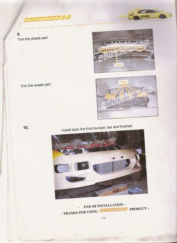

I,ve just scanned this for you , i,ve got the same FMIC and these are the fitting instructions that came with mine , might not be very clear but the first pic shows how much to trim off the bottom section of the apature and the second is the splash shield that,s under the bumper , HTH bud .
Would you be able to email that i have managed to find the instructions they sent me but they are slightly different to yours my address is richard@cunnington8.orangehome.co.uk
that is fantastic i should hopefully be able to work it out from there cheers to everyone thank you for your help
