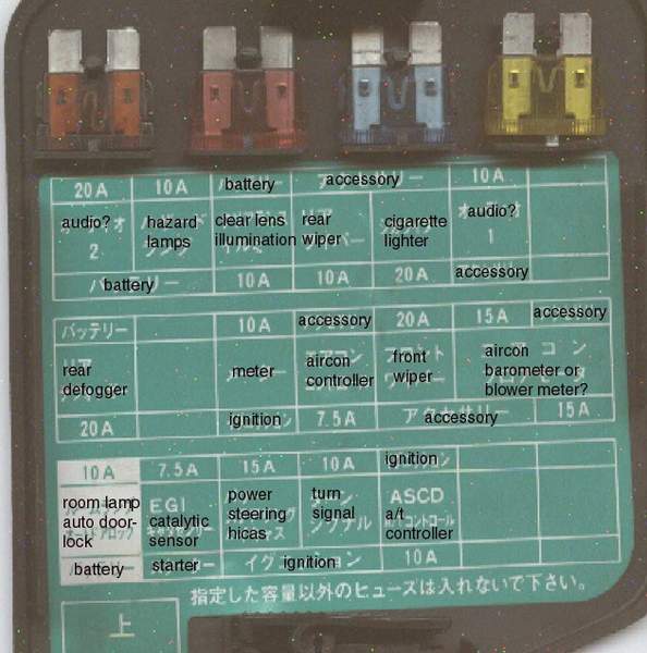

Got a problem with the driver's side front indicator. The bulb won't illuminate, so i checked the bulb and the bulb is fine, I even tried another new bulb just in case, but still didn't work. So, checked all the fuses (couldn't tell which was which - due to jap writing) which were also fine. So not really sure what's next. It was working fine, but on a recent long run I noticed that the right turn signal was flashing at double speed, so thought it was just the bulb..

If it was flashing at double speed it normally means one bulb on that side has blown. Did you check all the bulbs down the drivers side?
Edited by Eggs

im guessing it cant be a fuse, as 5 of the six flashers are working??
