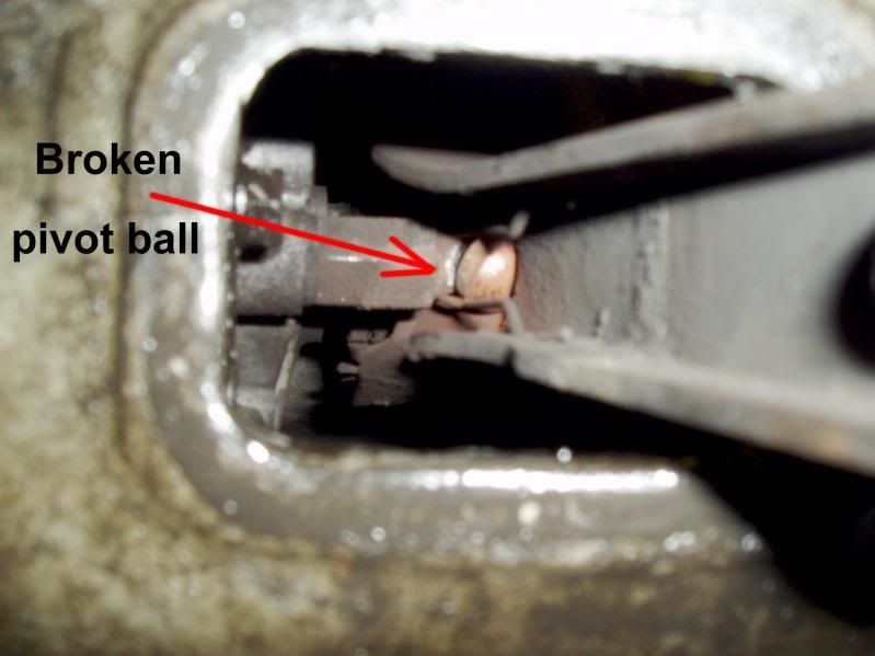

However by removing the actuator fork rubber boot where it enters the gearbox revealed the problem a broken pivot bolt, not unheard of but not that common to be fair.

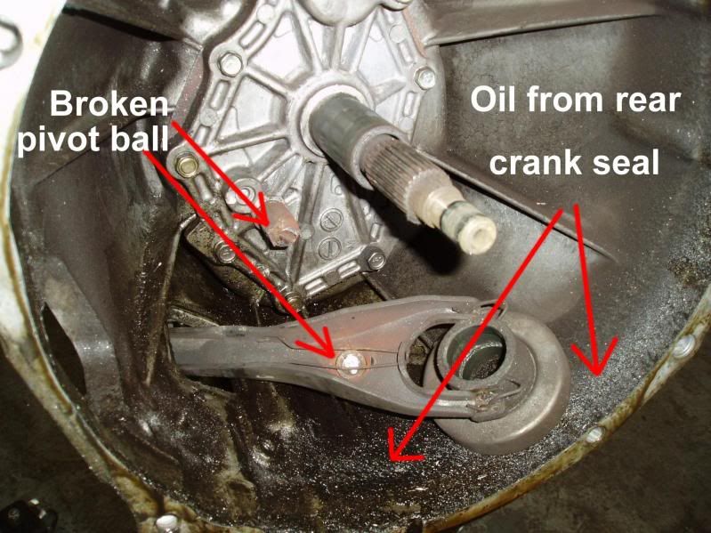

Nothing for it but to remove the gearbox, a clearer view of bellhousing and the operating fork pivot bolt.

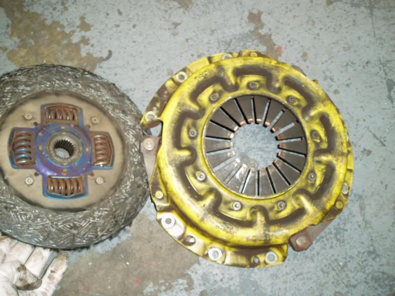

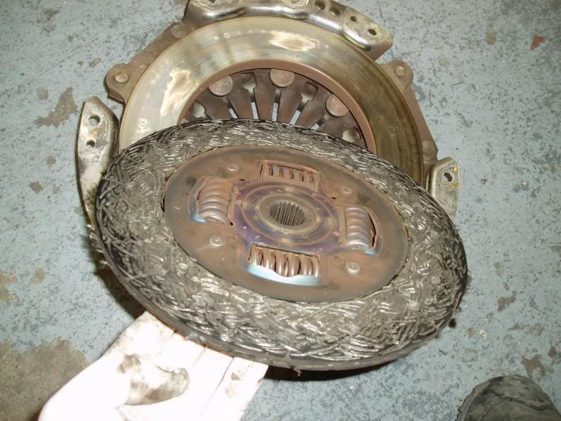

The clutch plate and cover were not looking to good and when measured were way below minimum.

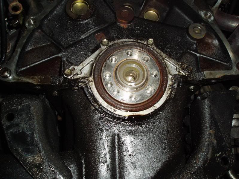

Silly not to do the rear crank seal whilst we were in there....
A new 6 puck clutch unit was chosen to suit the way this zed is driven and used, such a shame its not visable when fitted...lush!!
