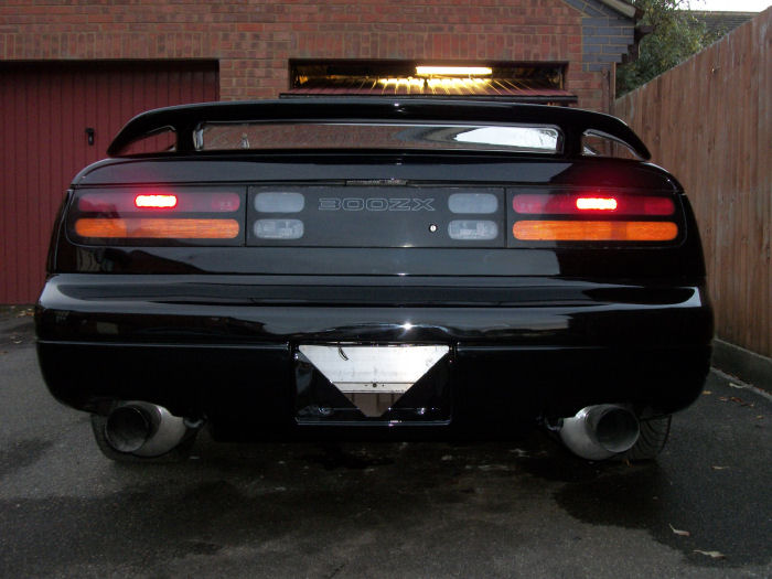

The cars gone to the body shop today and we test fitted the fibreglass rear spoiler last night, quick question, is there another trim piece to fit on the rear lip of the boot lid as fitting the replacement fiberglass leaves a big hole in the middle and to me would look unfinished???

Are the 2 weather trims about 2 feet lonf and one on each side???
Yep they sure are as Jakai has said they leave a gap of about 6" in the middle for you to lift the tailgate with.

Steams if I'm looking at the back of your car whats on the rear of the boot though as your spoiler sits above where the standard item lived??
Thats the area I'm on about??
That's a 99 spec, it's bolted onto the top of the tailgate, under that is the weather strips and then a perspex strip goes over the top.

Might be the Perspex strip I'm going on about then, could you post a picture if you get time?
Just want the car to be done right while it's in bits for paint.
Hope it looks as nice as yours when it's done!!!!
Here you go mate, you can just see the weather strips under the perspex strip, they just push on.
ps. I've fixed the drivers side one on mine so it doesn't sag anymore like in the photo :)

That's the one might have to get one bought, recommend anywhere please???
And thanks.
Nissan is just as cheap as everywhere else mate. Ask MJP in our traders section. It's available in two flavours, with brake light and with out.
Your welcome mate :)
Without a brake light I think and some modifications to make fit but it will clean the backend up.
