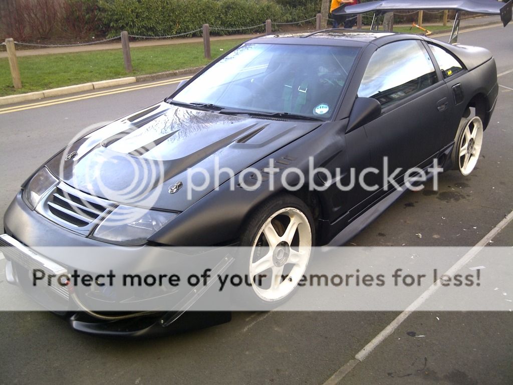

I've been painting all day, what do you think so far?
I'll give it a couple more coats of satin black on Tuesday, then it'll be ready for decals (anyone a photoshop guru?)
it's getting there :thumbup1:

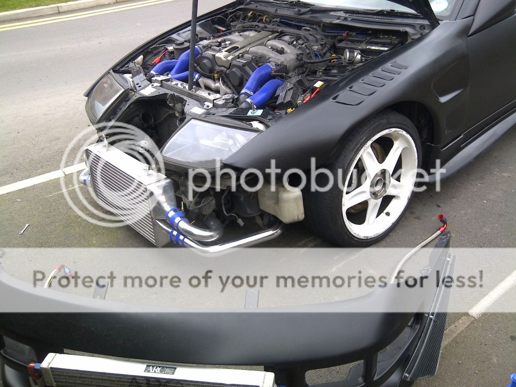

first of all they delivered my new custom fmic pipes (ACL Engineering, Rotherwas), so it seemed rude not to fit them straight away

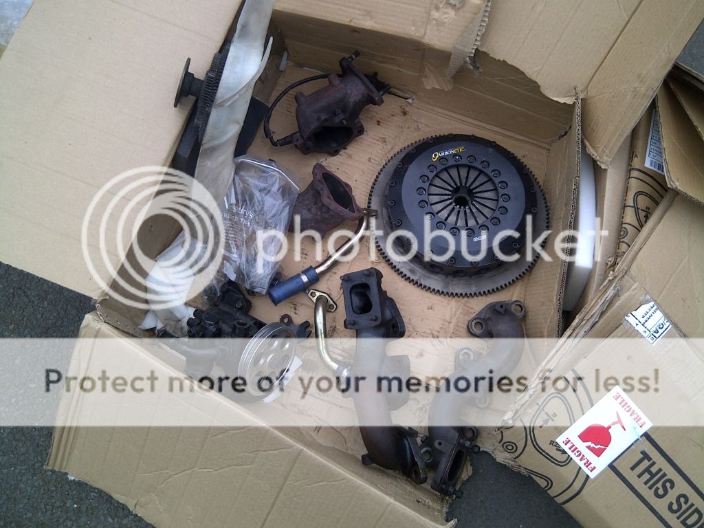

and then DHL turned up with a couple of boxes from a secret source :ph34r:

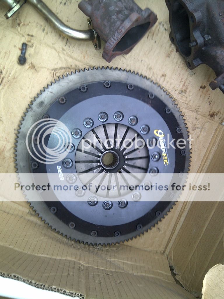

Carbonetic triple plate clutch

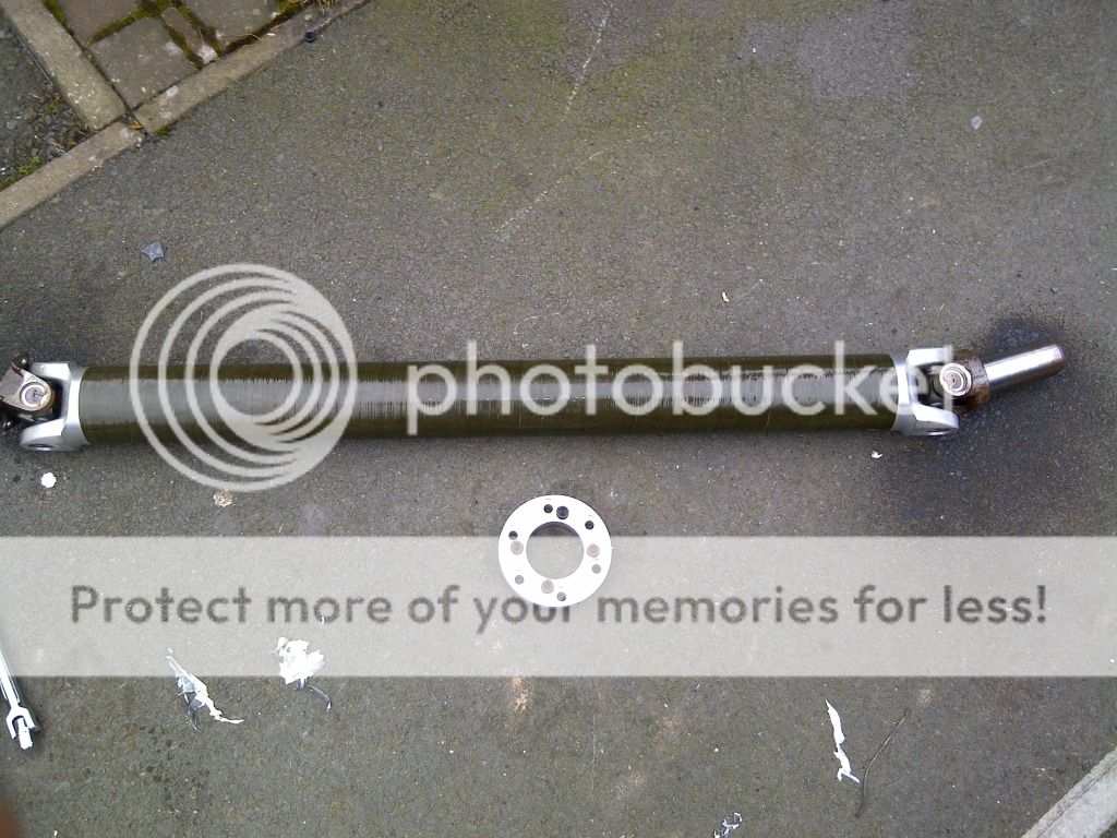

which will marry up nicely with this awesome carbon bad boy (cheers Bob)

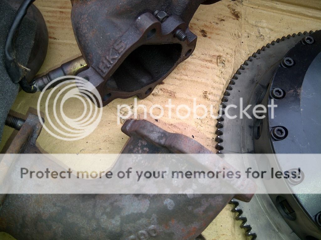

HKS elbows/downpipes

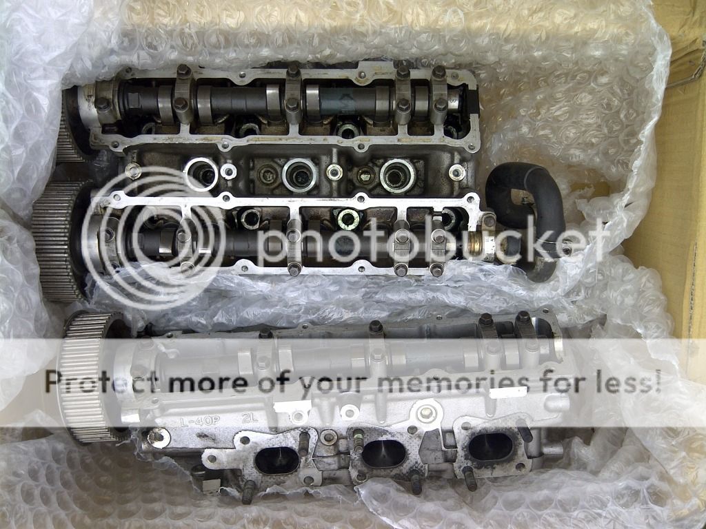

ported heads and some aggressive cams and AMS pulleys
and some other bits mani's, pulleys etc

looking good mate, but i would def move that oil cooler, for track stuff its in a bad bad place, if you spin off and hit it its game over also not to sure how well it would go down in scrutineering due to how easy it could get damaged and spill oil on the track
I might aswell start a proper build thread now as it's nearly finished, as you say Baz, with some before and after pics
That's a fair point reagrding the oil cooler, I might turn it around and fit it inside the bumper. I'm looking for some quick release self sealing connectors currently, I think Aeroquip do them for fuel hoses. That way if the bumper gets ripped off in an off/bump etc.
