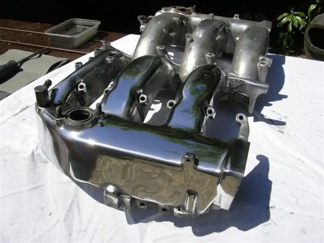

Ive started polishing up the plenum off my old 'Wasp'.
Trouble is, every time am on my own with the dog and try to use the dremel, he goes out and howls!
I'm strating off with the dremel and grinder attachment to knock off the worst, and the casting marks then is grafting away with the wet n dry after that.
Going to be slow progress but taking pics along the way... :)
Original:
Now:
i would only use a dremel for the very tight bits. I used a file sander for in between the vanes and large sanding disc for the rest otherwise it will all be uneven. I realised the mistake in using a dremel after i used it.

I expect yours to look like this tomorrow :lol::lol:

Day 2 then, no power tools at all today, just good ol' wet 'n' dry paper and elbow grease, she aint doin bad considering she's out the house at work from 6-7am and isn't back until about the same time in the evening
It's coming on nicely :) Can't fault her work rate. It'd take me days to get it like that lol
Seriously Alex, you are no where near the wet and dry stage yet, so tell Rose to stop killing herself :biggrin: I did mine with as much machining as possible ( being a lazy git) and then before the cutting and polishing mops, hit it with wet and dry. As long as you havent taken a load of gouges out of the metal, machine it as much as you can till you feel and see the smoothness, obviously upping the grade for each pass.
Mine took me over 60 hours roughly, so hopefully you will take my advice or you wont see Rose again till the summer.

Just set off with normal sandpaper 1st , I set off the the green 60 grit down to the yellow stuff 80grit then i started with the wet and dry. She will be there forever doing it the way she is and she will use loads of the stuff.
