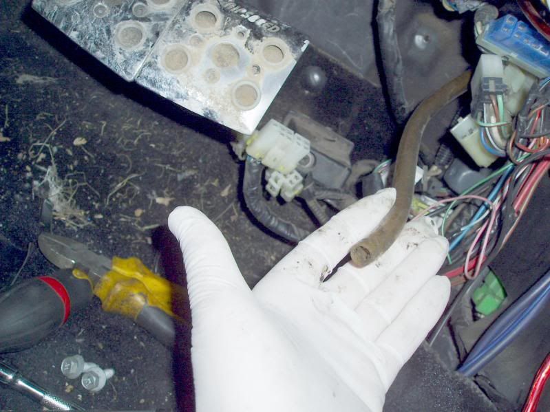

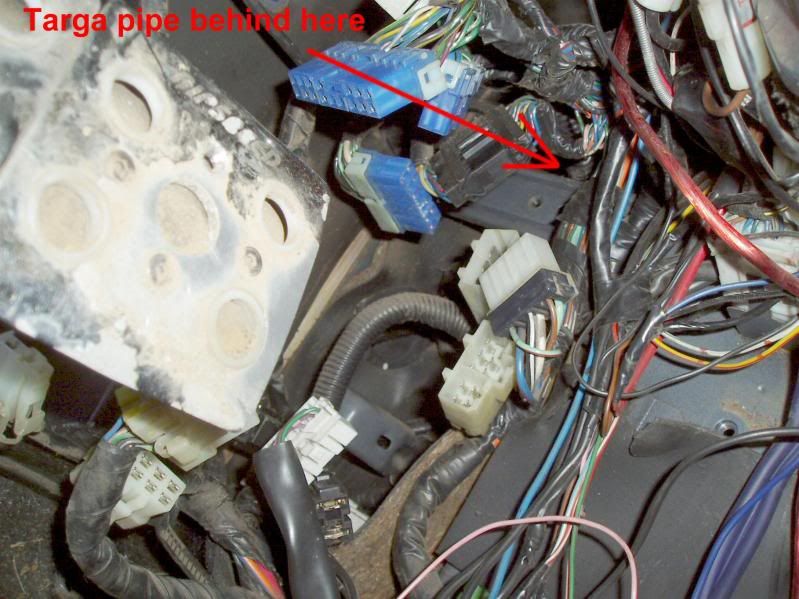

So with the fuse box removed you see this......

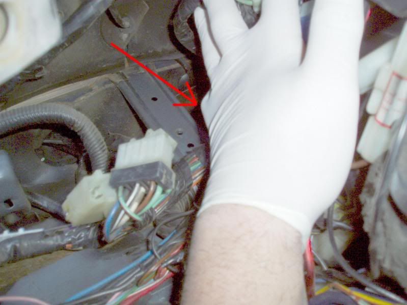

Push back the loom....

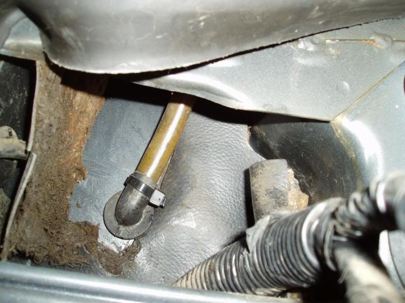

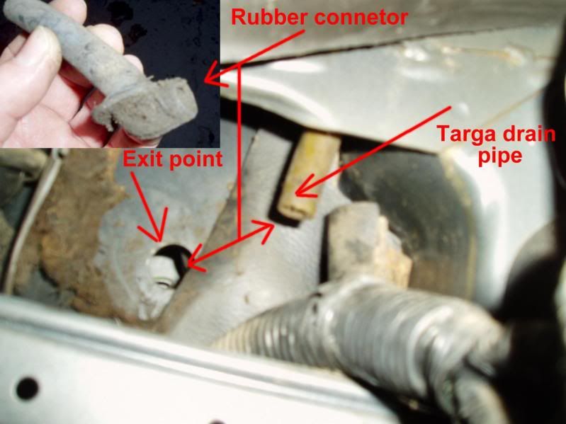

No you can see the pipe end and the hole where the rubber end should go to, the rubber end was already removed at the point......

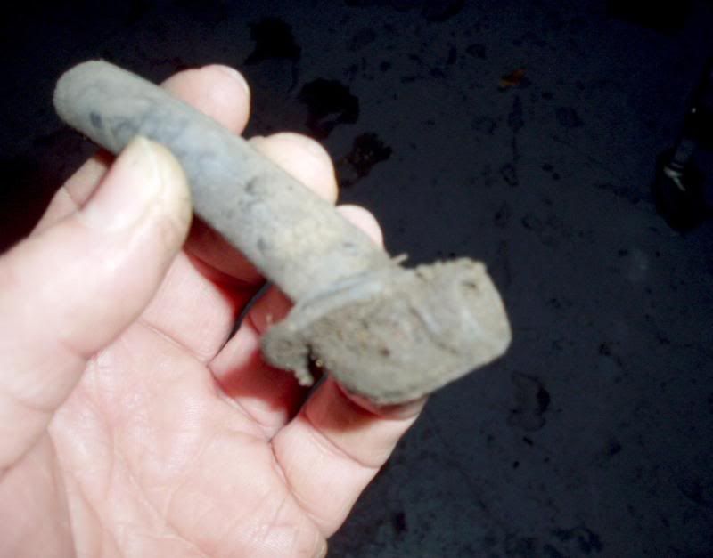

Here we can see the rubber end drain that fits to the end of the targa drain pipe, although the real issue was it was disconnected it was in fact also blocked, so before it came detached the water would have been backing up within the pipe.

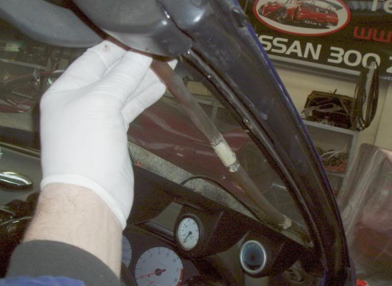

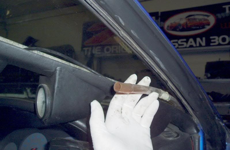

So back to the top of the A frame and with the inside trim removed you can see the targa pipe connection to the roof drain, this now needs disconnecting
Now carefully push the pipe down the A frame whilst pulling the pipe at the lower end.
Once the pipe is part way down the A frame stop, do not go to far down as it can be a pain to fish it back up.

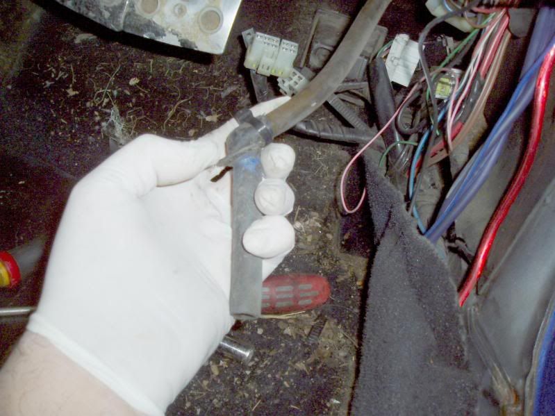

So now the bottom of the pipe is more accessible to work on.
With the rubber drain cleaned and glued in place a cable tie is attached for double connection.

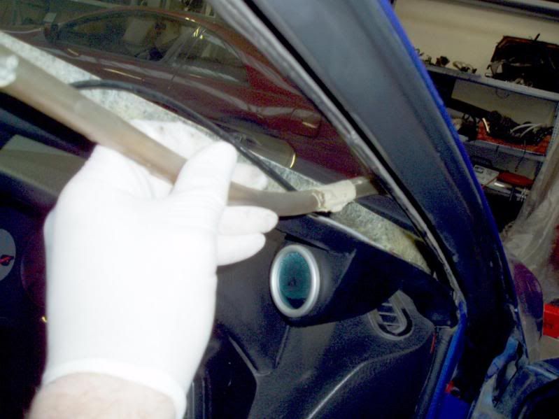

After the pipe is pulled back up the rubber drain can be passed through the side panel, its has a rib in the rubber which is very easy to locate and secure.

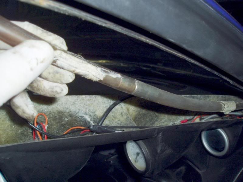

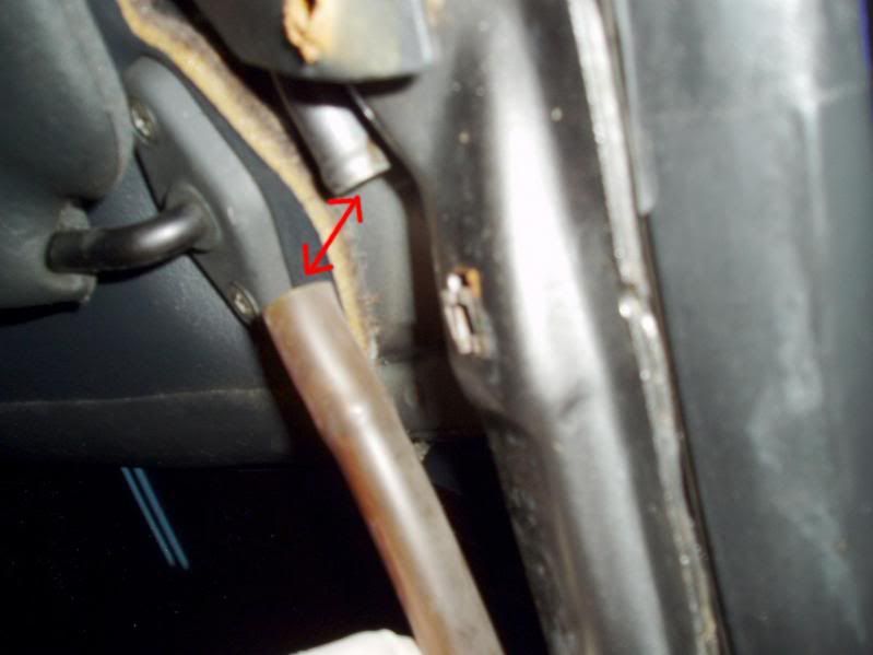

No back up to the top you can see how short the pipe had become by shrinking
Cut the pipe half way down and insert a small metal pipe section, this will give you the extra pipe length to connect the pipe at the top of the A frame.
So there you have it, you can always pull a new pipe through to save inserting the pipe connector, but have done these many times and is very easy, replacing the fuse box, accelerator cable and bonnet pull lever is a breeze now and all done.
