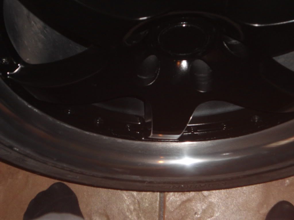

Hi guys Decided to try do some work to my wheels myself,
Some wet and dry paper from 60 to 2500,
autosol metal polish and cotton cloth,
halfords can of grey primer, and gloss black,
I pulled the metal lips off(fake polished rim Stuck over the edge of wheel) which had black powder coat underneath,
And pulled all the allen keys out (decided to leave these out for the moment)
will get them done in the shop 1day but i think they look ok for the moment,
I aint the best sprayer and never polished any metal before, and dont think i willbe polishing anymore in a hurry, my hands were bleeding, and have no finger prints left..5hrs on each wheel all by hand never again,
well here is some pics:

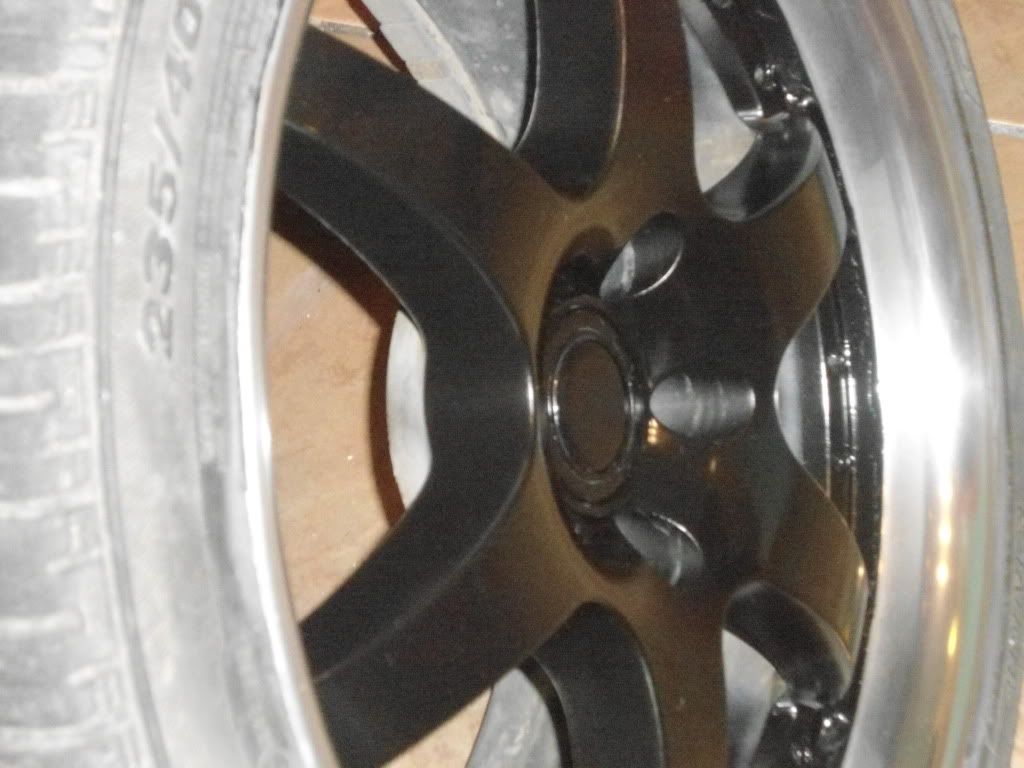

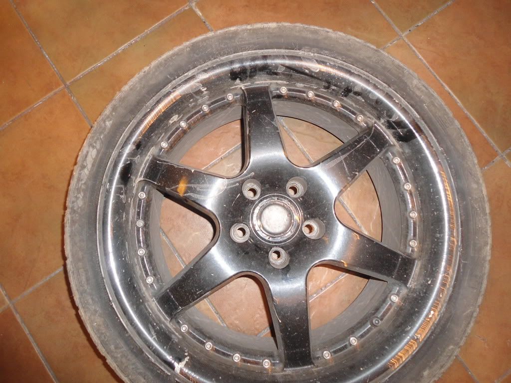

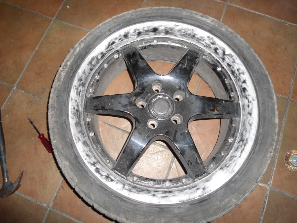

one wheel with lip removed and powder coat:

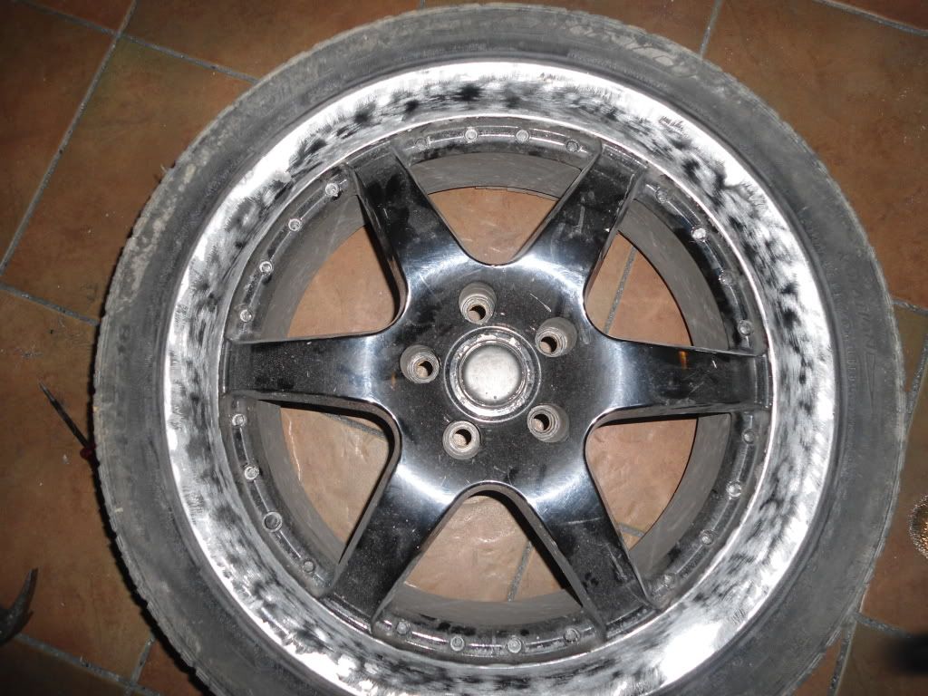

a pic of starting to remove powder coat:

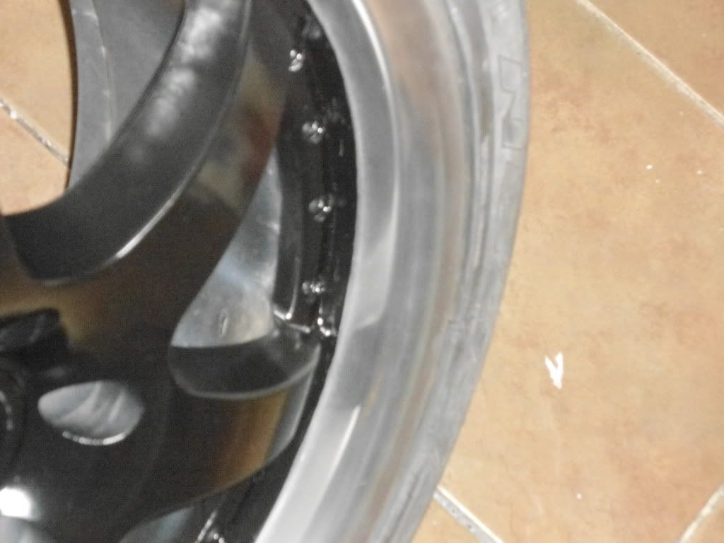

And one finished:

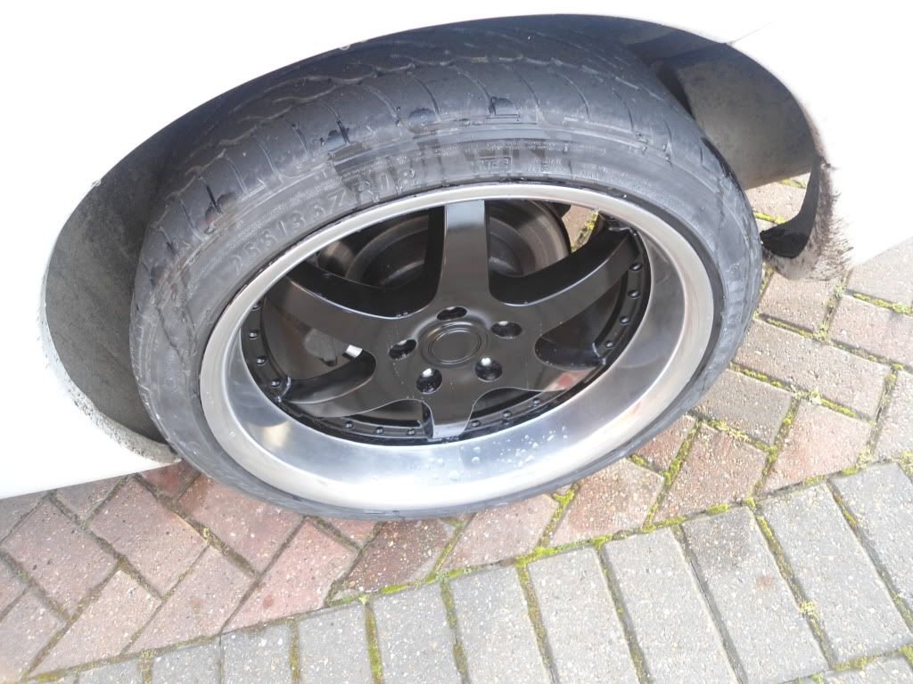

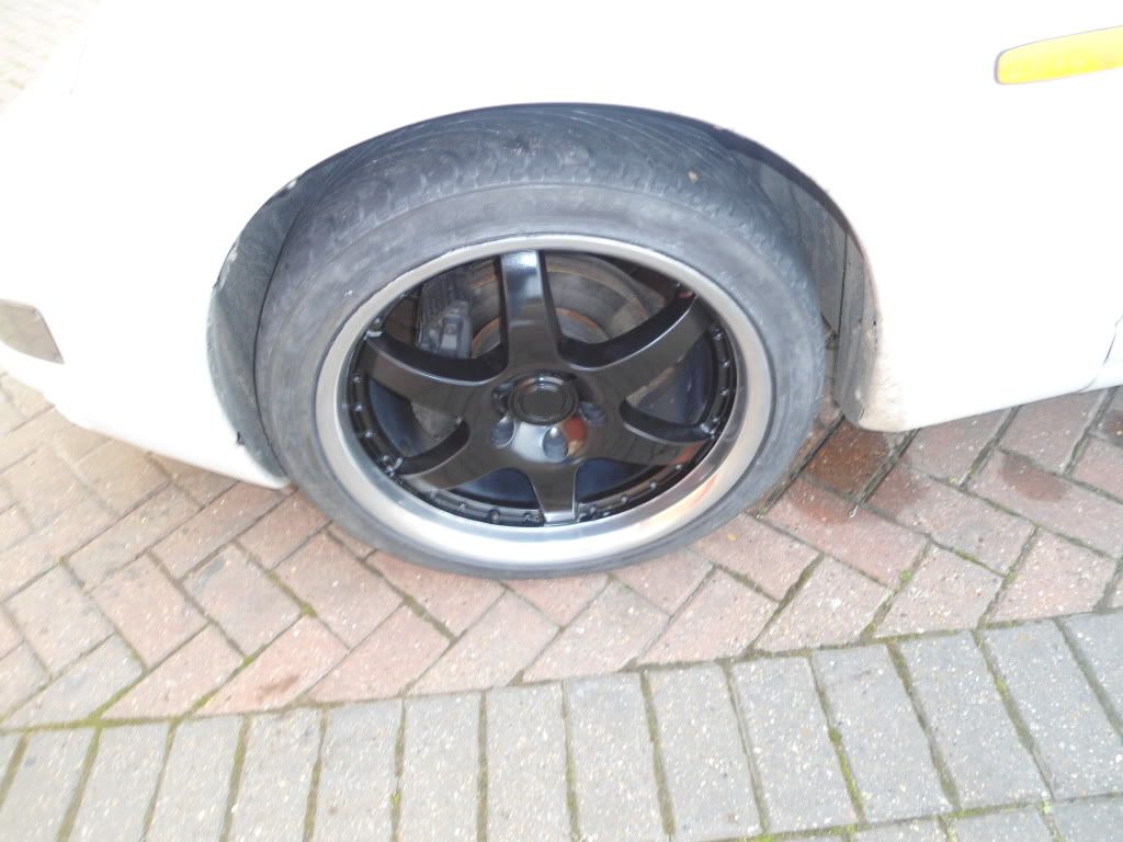

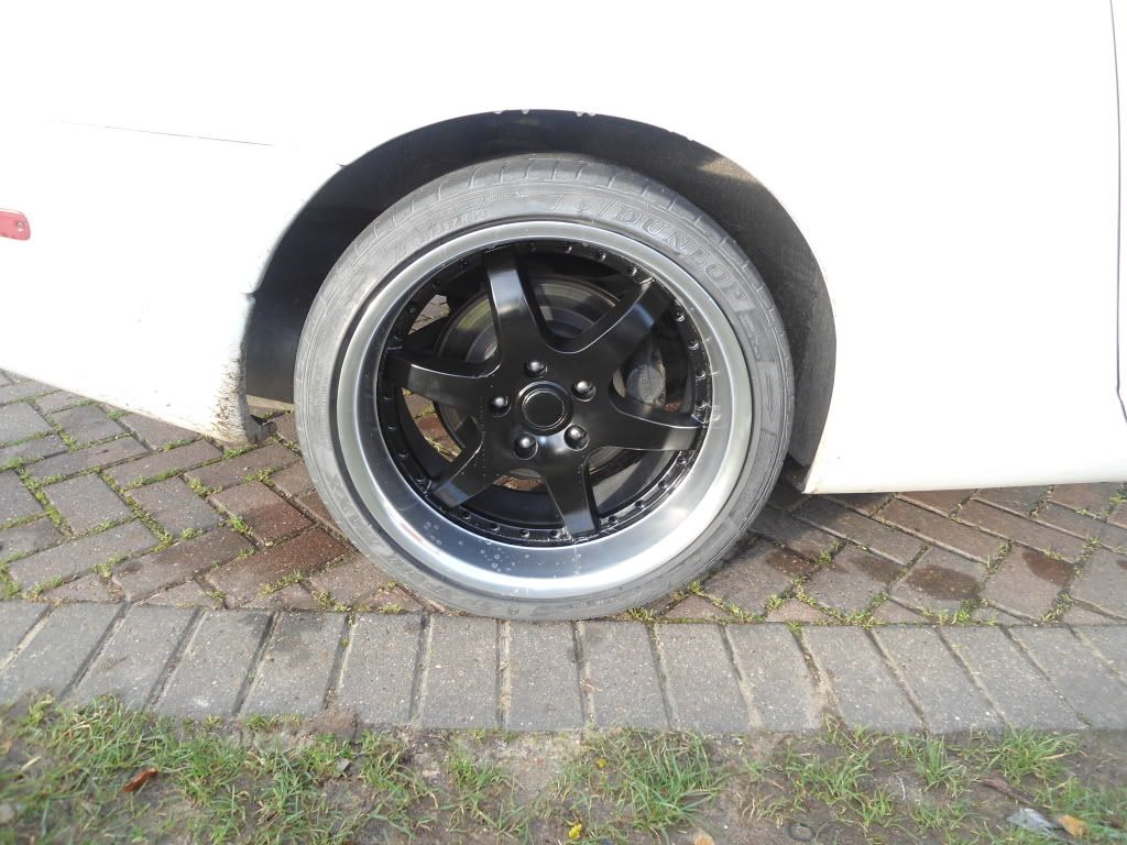

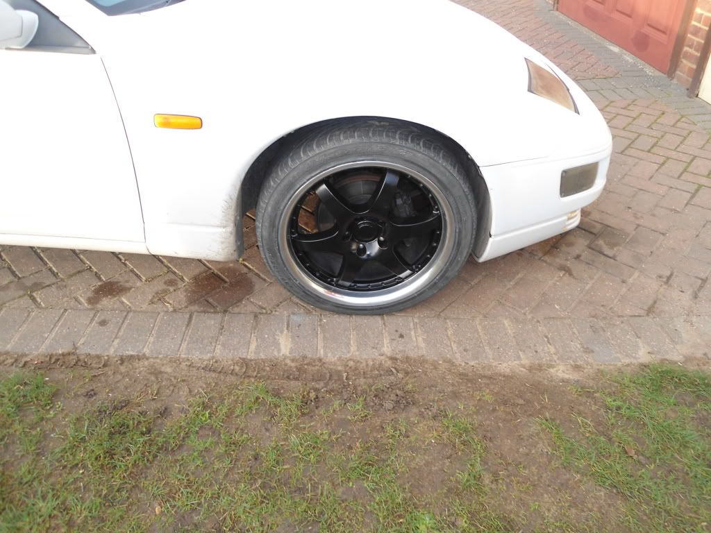

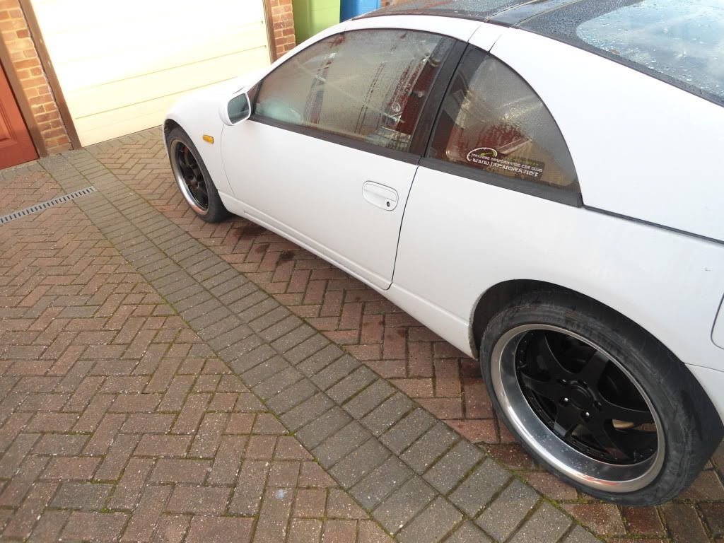

Couple on the car:
Lots of pics lol,
Cheers for looking.

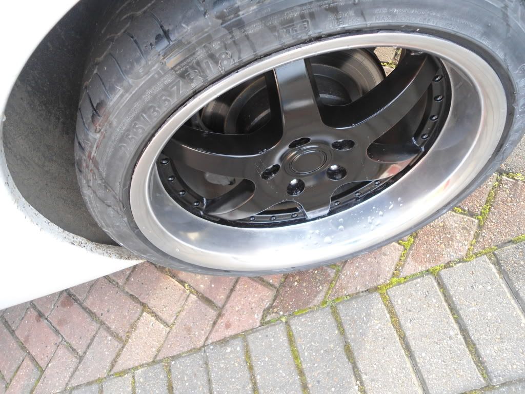

look spot on them mate. Get some decent wax on the rim or it will start to look dull and pit pritty quickly :)
They allready have started, got to polish them again, went to my mums the other night and they salted the roads why i was there, and had to drive home,
There covered in salt, and gone dull, was a good idea why it lasted not to sure now i will be cleaning them every day, And the zed aint much better looks great when cleaned but its white so with in 5mins its filthy.
Will any wax do or is it a special wax i would need.
Respect :thumbup: we bleed for our cars!!!
Some tyre wall black will also improve the appearance...top work :yes:
Tyres are rough there on the limit now gonna need changing, But they do look funny colour, worse on my crappy camera.
I bleed to much for this car it drives me f@#king mental lol any other car i would have just scrapped it but oh no not the zed.
Yeah they need protection, you can buy Rimwax off ebay. ment to be very good but i have never used it. I use to use some stuff called collinight or somthing like that.

There a mission to polish, and the fake chrome bit comes off easy took 15mins to do all 4, thought i would have to take tyres off but they just split in half and pull out, (be careful they are razor sharp)
And i removed allen bolts so could paint them, and left them out. just hammered a flat head screwdriver into each one twisted them and pulled them out.
