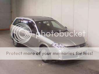

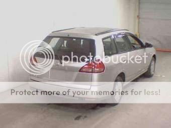

and if you need a car mate, I've got a tidy low mileage import Nissan Wingroad estate (similar size to Astra estate) that I'm gonna' be putting on ebay shortly starting price of only £700
automatic 1.5ltr engine with fantastic fuel economy, with full 12 months MOT, new tyres and only 50'odd thousand on the clock
Does it look like this one :cool2: http://rds.yahoo.com/_ylt=A0PDoYCQhxRPAlkAeqSjzbkF;_ylu=X3oDMTBpcGszamw0BHNlYwNmcC1pbWcEc2xrA2ltZw--/SIG=13gm3fk9e/EXP=1326774288/**http%3a//www.cars-directory.net/gallery/nissan/wingroad/2003/nissan_wingroad_3845656_orig.html
Unfortunately no....it looks more like the one above it
it's crying out for a VG transplant though :punk:
ultimate sleeper!!
