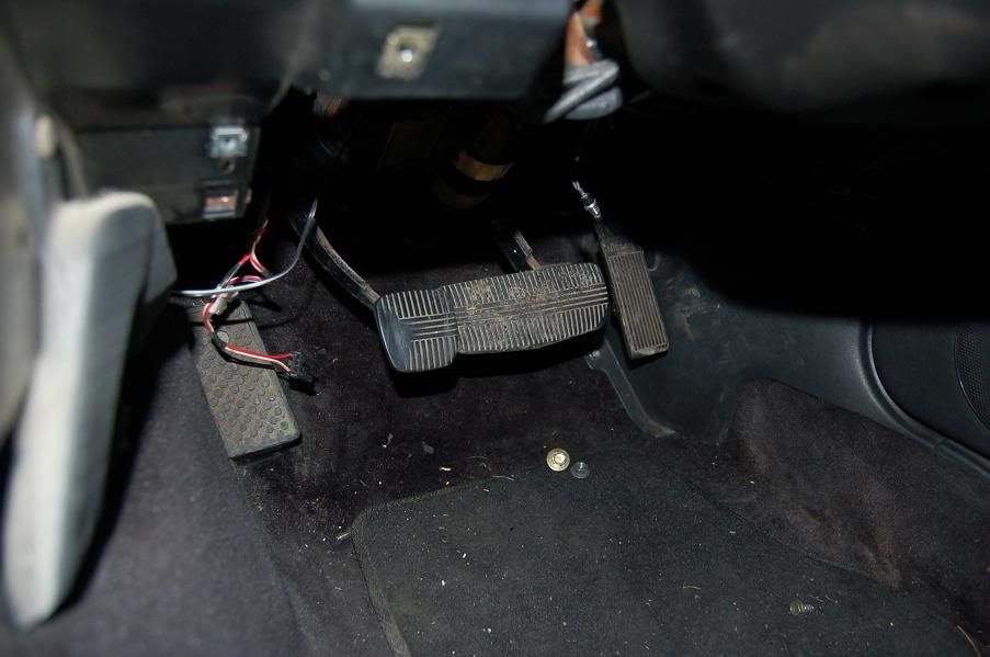

Guess what I've been upto today
any ideas... :cursing:

haha, Alex was right - I've fitted an extra large brake pedal into my manual TT :lol:
Nah been busy converting the NA to manual, I wasn't looking forward to the clutch pedal bit, and it certainly didnt fail to irritate me! :lol: Especially as I've got a narrow drive and the drivers side is right up against the wall, so I couldnt open the door. Took the seats out (found £3.42 and 8 japanese coins!) and laid down. Took the targas off to keep cool and it started raining, got a brand new LED maglite and it kept turning itself off with the slightest knock against anything! never mind, its done now! :thumbup1:

Does it actually look any good Gaz? I cant imagine so. I've got a manual brake pedal to fit, unless someone can convince me otherwise! :sweatdrop:

You an cut it down to the right size and fit a manual brake pedal rubber (or clutch pedal rubber) over it, and it looks completely oem.
Cutting is a PITA though as there is a thicker part in the middle of the back that you need to get through, and its at an awkward place/angle.

Cheers guys, might have a go at cutting this one down then, I didnt think of changing the rubber on it! :sweatdrop:
Yeah just cut it down mate, much easier than swapping the pedals over. That's what I did and you can't tell the difference. As Yowser said though it's a bit of a bugger due to the angles, I used a junior hacksaw and it wasn't that bad.
