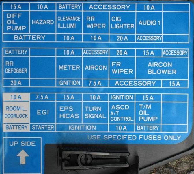

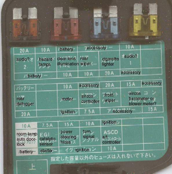

I've searched but the pic I found is not the same as mine. Can anyone post a pic of the inside of their kick panel in English or translated please?

Jap one
UK one
Does this help

pic added
Sweet thanks Stu i'll check it out next weekend. Does anyone know where the fuse for the electric mirrors is located?
