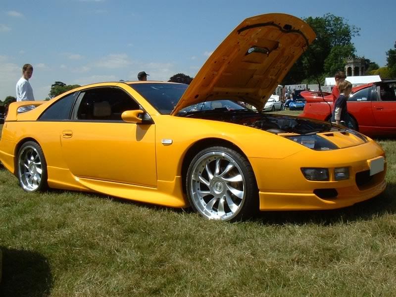

The wheels are looking a bit tatty. I was thinking of getting them refurbed. They're 'Ace Turbines' - polished alloy outer lip, painted inners with plastic centre caps and there's plastic fake bolts round the edge of the painted bit (fake split rims I guess).
The alloy lip and painted inner aren't too bad but could do with improving (scuffs and light corrosion removing and re-finishing). The plastic fake bolts are looking tatty and I suspect can't be replaced or easily improved.
Would it be possible / a good idea to removed the plastic bolts and fill the holes with filler or something?
I was thinking either paint/coat the whole wheels or just do the inners and re-polish the outer lip having removed the parking scuffs.
When I say do all this, I mean pay someone else to do it!
Any idea what would work well?

They're like these:
same wheels as dazvert has on his silver TT zed, http://300zx.co.uk/forums/vbpicgallery.php?do=view&g=782
Make sure they are defiantly plastic bolts before taking them off, if they are and there is no visible join, then id say good to go, as the plastic bolts will only be for decorative purposes to make them look like split rims.
One of my friends is a powder coater and he charges £140 for 4 wheels,that is shot blasted and powder coated in any colour you want, and is work is excellent

Yep, same wheels as mine, nice one, the plastic bolts are on the inner wheel stud covers and can be replaced with stainless ones and some little nuts on the back, try Derbyshires in Southport, they have the same allen bolts :)
http://www.aderbyshire.co.uk/Index.aspx?GO=CONTACT
Thanks, good advice. Just remove the plastic ones and put the stainless ones in instead? What size stainless fit? M6? M8? I'm rubbish with this sort of thing!
