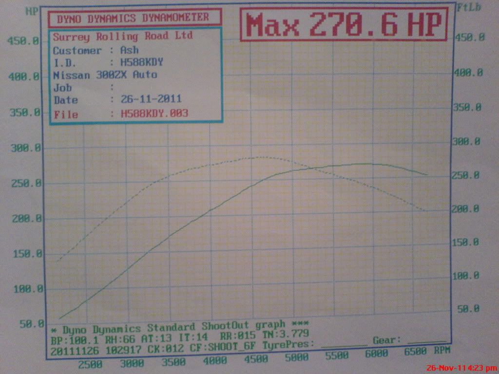

for the record just had mine dyno'd
running zedworld chipped ecu and their boost jets, full decat exhaust and good filter, much cooler hks plugs.
std internals and injectors and the fuel map is perfect at 0.8 BAR or 12psi, any more boost and id be running lean, (which isn't good) can only talk for my zed,

You able to post up the dyno sheet for us mate?

What was it kicking out?

ill see if i can find the air-fuel-ratio one, but it was ~12.0 under full 0.8 BAR boost (3000rpm onwards) and ~16.0 at idle.
bearing in mind it's an auto was 270RWHP (rear-wheel not flywheel) and was a nice smooth curve, i wanted more, but it'll do for now
