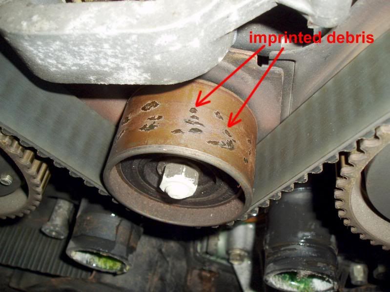

Case in point last week, new owner and despite been advised by the previous owner it had been done and had little mileage on it he decided to get get it done anyway as there was no proof.

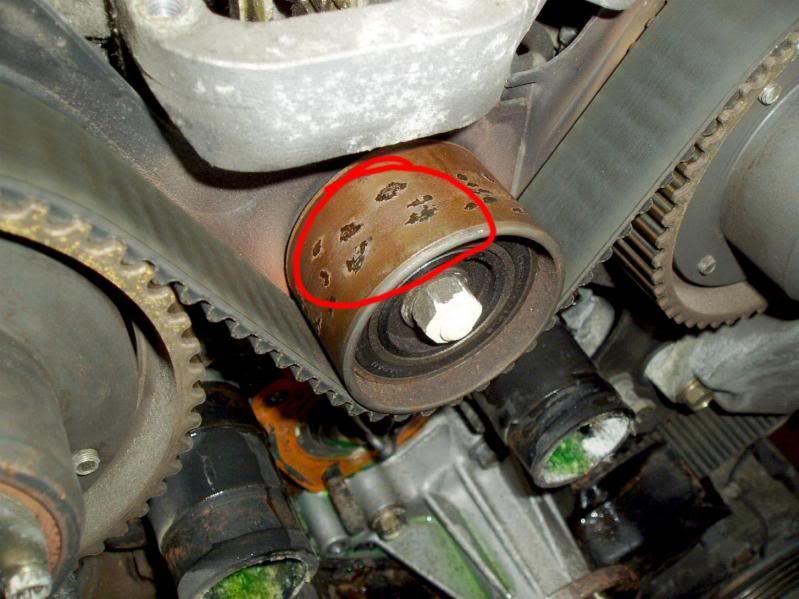

When the front was stipped down the belt did look from a quick look in good order, but the belt pulleys told a different story, the imprinted material is a mix of belt fibre and general dirt pounded onto the surface of the pulleys by the rolling action of the belt.
To be fair this is not too unusual but given the belt had been changed ( along with a water pump too ) suggests the imprinted material was from the previous belt and had not been cleaned off! as it was the pulley was toast anyway (noisey) so was changed along with a new belt, not a biggy I know but does show some lack of care by who ever changed the belt.
Just because it is an area not seen once the covers are on there is no reason to not be as keen to clean it up when in there as anywhere else, in fact we always blow out the area with an air line and the amount of fine black dust that comes from in and benhind the top sprockets is surprising.
