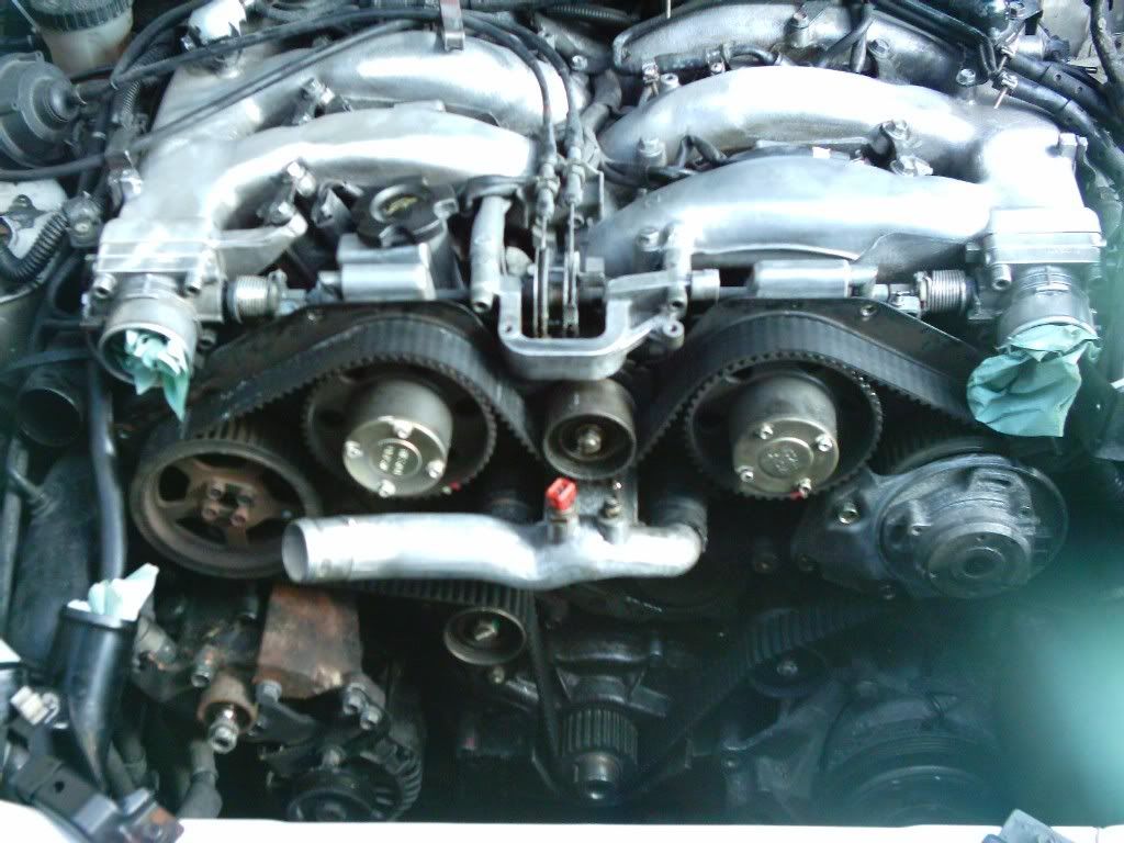

Here's a pic of when I changed my pump and belt, just to give you an idea of what it looks like :)
Thanks thats a great help and gives me more confidence in doing the work myself.
