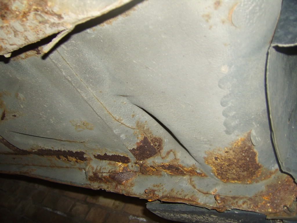

You should have asked him if you could pay to do a pre-mot, or even a normal mot at your expense before you bought it. Luckily I worked in an MOT station and got mine looked over for nothing, and it just needed a little bit of welding to pass with no advisories :) I got the car for a bargain although I knew the turbo was on it's way out though.
Brake callipers could 'possibly' have a seized piston or 2, seal kits are pretty cheap tho, easy to do. Just a thought mate...

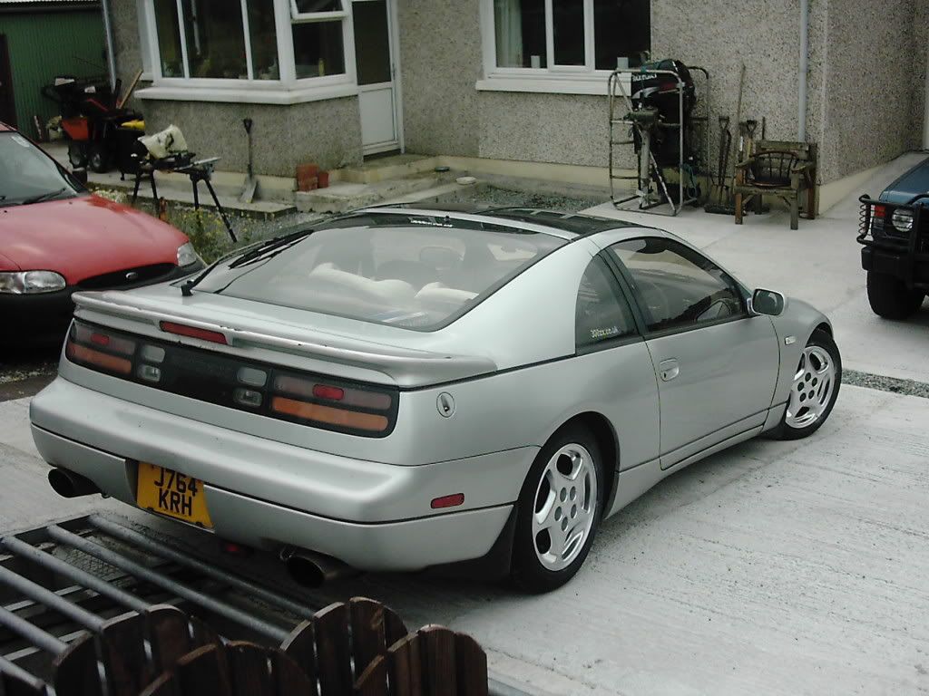

Hi all, welcome to my restoration project for my 300zx fairlady Z
Its a 1991 Japanese import 2+2 N/A, it come to the country in 2005, and has had 5 owners previously to me, at one point it was owned by someone who was a member on this very site, though im still unable to track down who that was.

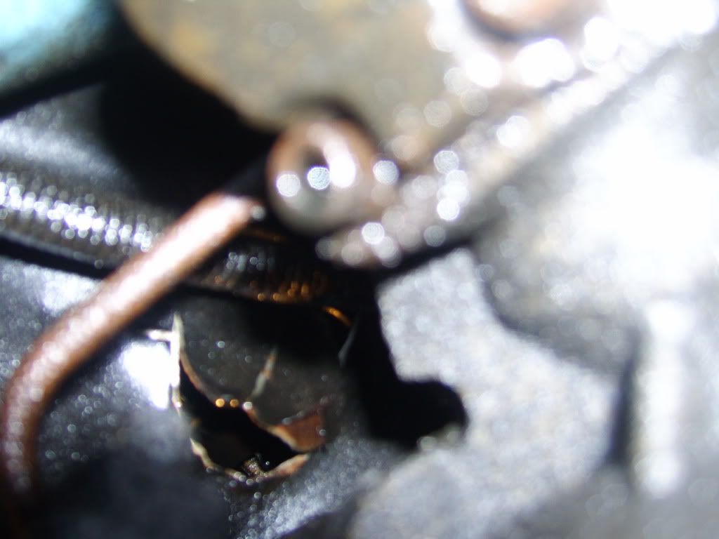

When i was doing the tie rod gaiter. i found i had a leak coming from what is basically a metal collar on the high pressure pipe from the power steering, this and the welding are the only 2 jobs i know of that i need to do for the MOT.
