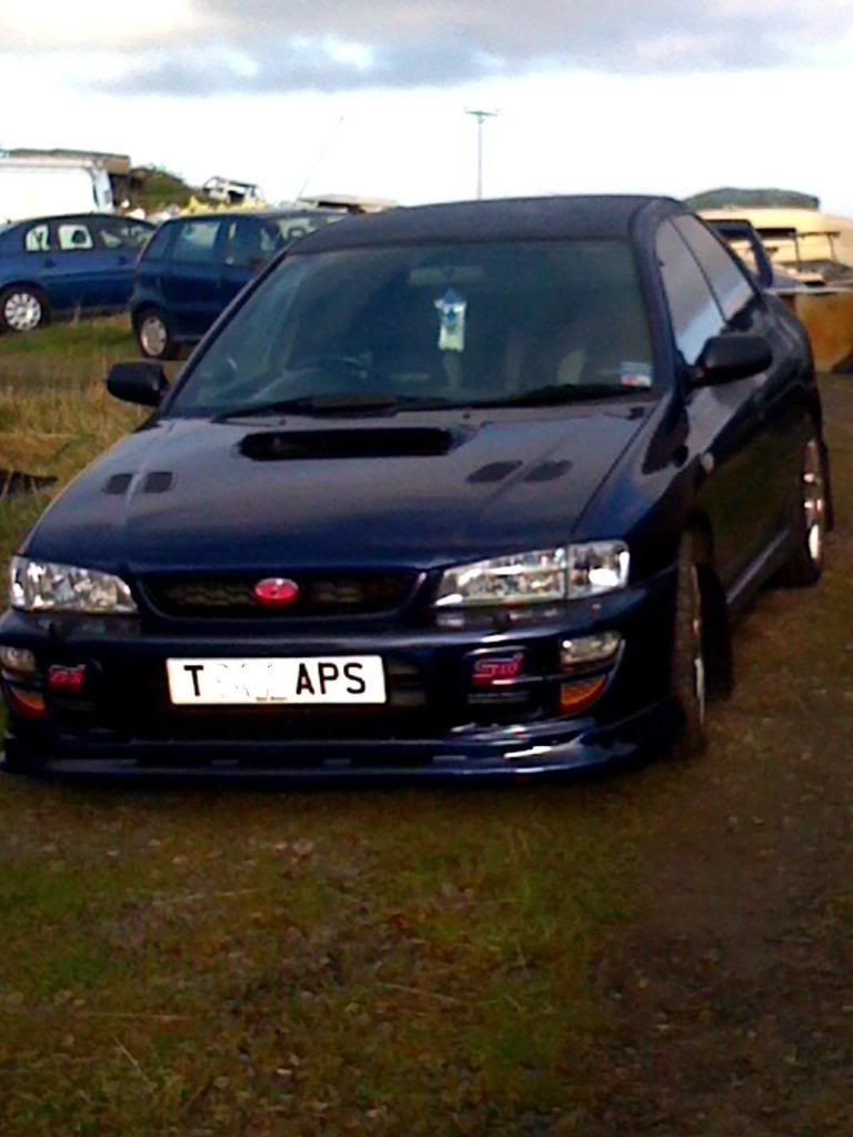

Parking the car up outside for winter is no good..keep it started even if its only every Saturday when you get a chance and reverse it back and forward to free the brakes and stop the discs rusting and wash / wax regularly .If its laid up indoors make sure its dry under the cover or itll rust too!Either that or just use it if you wash and hose the arches/underside regular to clean mud/salt itll be ok.I just spent the morning today fitting mudflaps and the afternoon spraying waxoil under my winter weapon ready for the snow/slush/grit.. bring it on! :DPicturesfromcampuntodigger02022.jpg
