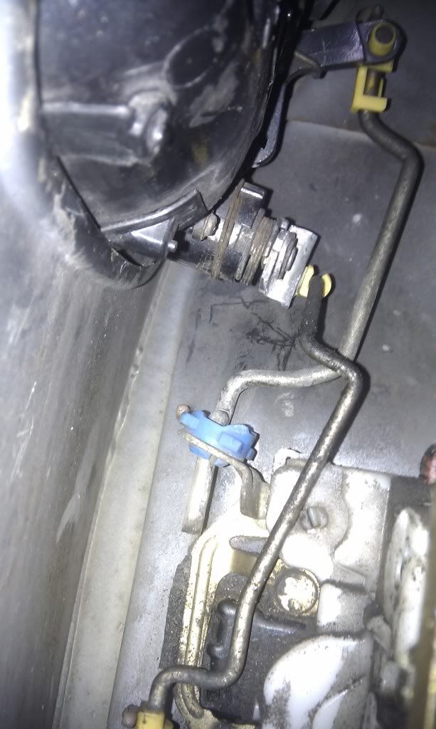

I have taken the drivers door card off and located the four wire connector, one wire is positive, one negative, then two pulse wires. I have measured with a meter when I turn the key in the lock, and the two centre wires get a positive pulse in turn if locking/unlocking. Putting 12v directly on these does not have the same result! I'm lost now, but hope fully someone will be able to help with the diagrams below - The unit is working and happily switching the indicators!

The picture youve posted is the CDL control unit
Ok, the lock on the passenger door doesn't lock the drivers door. You can see in the pics though there definitely is an actuator in the drivers door! The 4 wires in the door pic above, go to the solenoid - instead of a switch on the door lock, the mechanism relies on the solenoid being pushed in by a rod which then sends a pulse to to passenger side.
Any further thoughts? Surely even just by hooking my unit up with it's pulse would lock at the very least, the passenger door?
Yep thats the motor, you need to connect directly to that as reverse polarity
