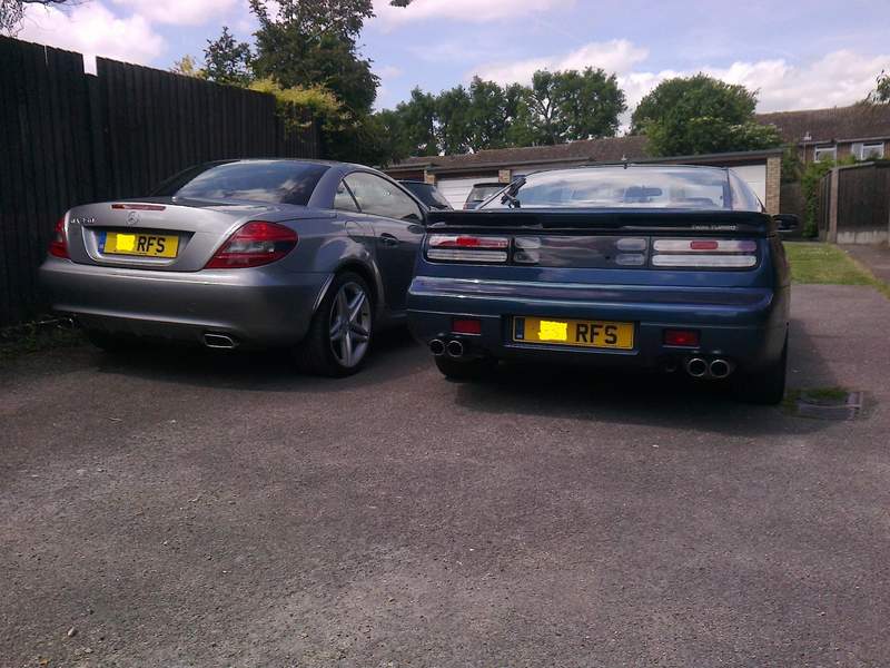

Plenty of cars have the rear fog built into the rear light cluster now and TBH the fogs can be pretty damn close to the brake lights!! Attached photo for comparison - although mine is a UK spec ZX with the fogs in the bumper...:surrender:
