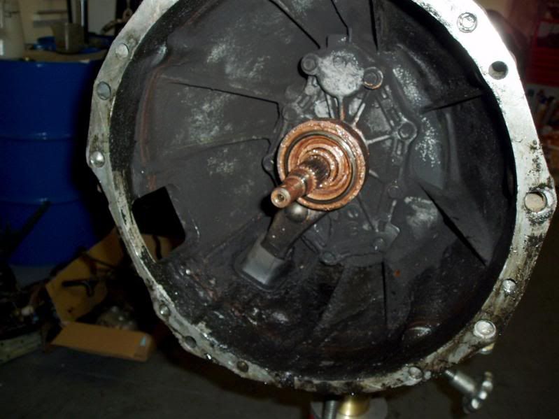

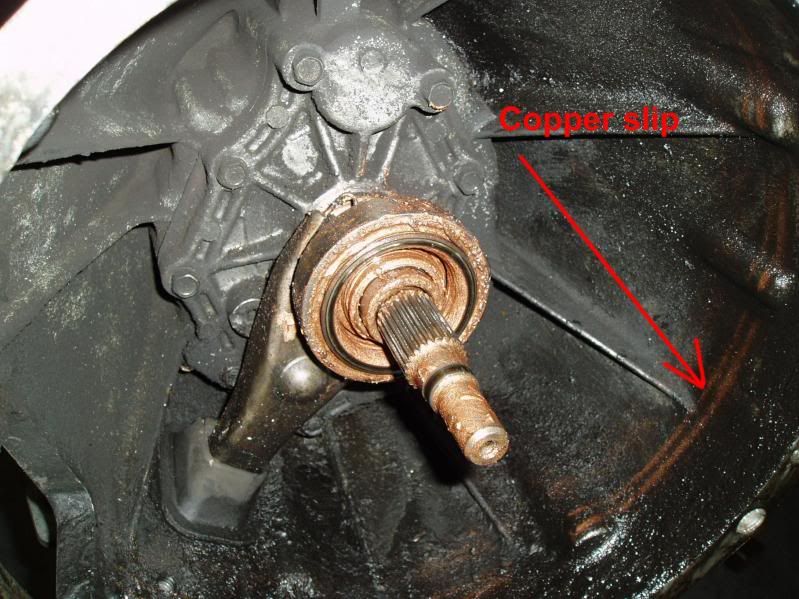

Al little knowledge can be dangerous, a well known saying that is proven over and over, see below, the amount of copper slip that had been applied to the release bearing in this already oily gearbox ( crank seal leaking) the bearing is designed to not need any amount of lubricant on the front face, this is stationary once it makes contact with the pressure cover fingers, the internal ball bearings then are the rotating point, of course the trouble this causes is it gets up onto the clutch face, see in the second pic the throw out lines of copper slip..... be careful if in doubt always ask!
