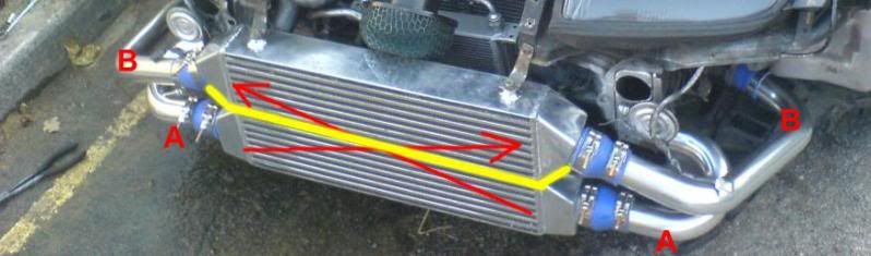

Think you will find you have piped your intercooler in wrong, you have linked your throttles, there should be a cross over when fitting fmc, as the left hand turbo will blow into the right hand throttle and vice versa.
This is the reason it cannot rev, the turbo`s are blowing into each other and the throttles are acting on each other. A AND B shouild be linked and not AA and BB

Yes all you need to do is swap two pipe on one side, top and bottom ,and thats it.
Jeff
and yet again my zed is saved by jeff and zedworld.... massive thanks everyone for your help, changed one side of the intercooler round and all fixed :thumbup::clap::thumbup:

so is a fmic seperated into two halfs??
Yes exactly, they appear to be one unit but are two seperate ones locked together.

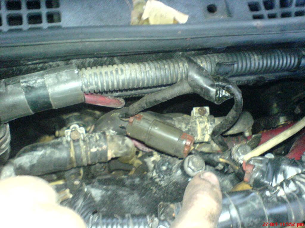

im thinking the code 34 was a real issue here, but in all honesty the det sensor has never been connected properly, i showed it in a picture on the previous page and the wire is broken in 3 places and has been since i got the car. :hammer:
but its never done this before and its not bypassed just broken.

great news after spending the last few days trying to work out how to rewire the det sensor, the wire was just disintegrating... i've managed to get it to work looks a bit of a bodge but its strong and isn't going anywhere, basically had to bypass a large section of the harness with a new wire. for some reason just the black wire was broken the other was fine??
