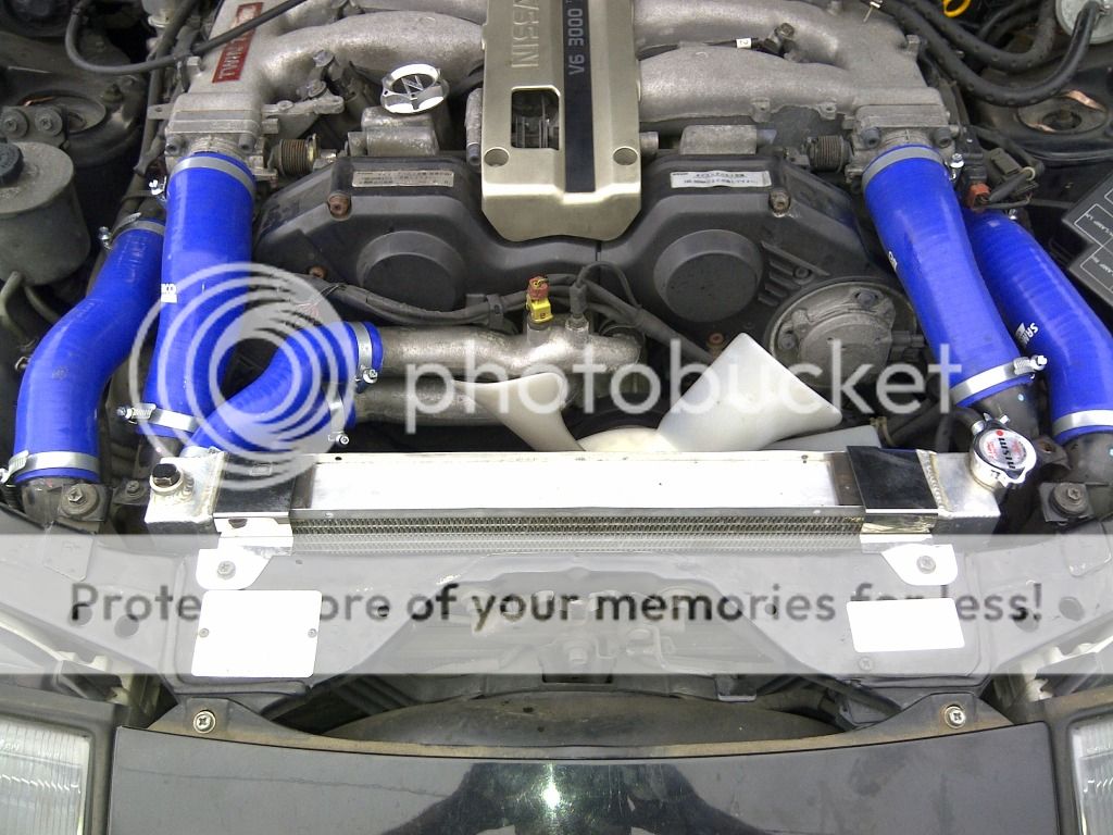

Well I spent an hour or so today swapping my old stock rad for a Koyo upgrade

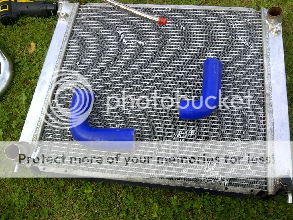

As always it was a straight forward job, with the only real bit of work involving the cutting down of the SAMCO lower rad pipe to accomodate the new hard pipe section.

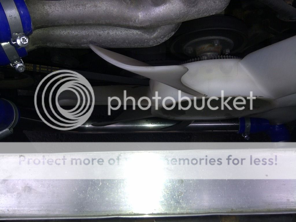

The only question that I have really is regarding the lower hard pipe. At present in doesn't catch and sits nice and snug however there is an abvious lack of bracket to secure it in place and as such it appears to be just swinging freely, not much but still not completely secure.
Is it going to be necessary to fabricate a bracket or will it be fine?
I don't have a bracket on mine and it seems to be fine!
there should be a bracket on the bottom of your old rad ?
alot are just sat with no brackets on though.
ive seen a few people put some tough foam between then the pipe and the anti roll bar and cable tie together before, but im not sure thats a good idea or not.
