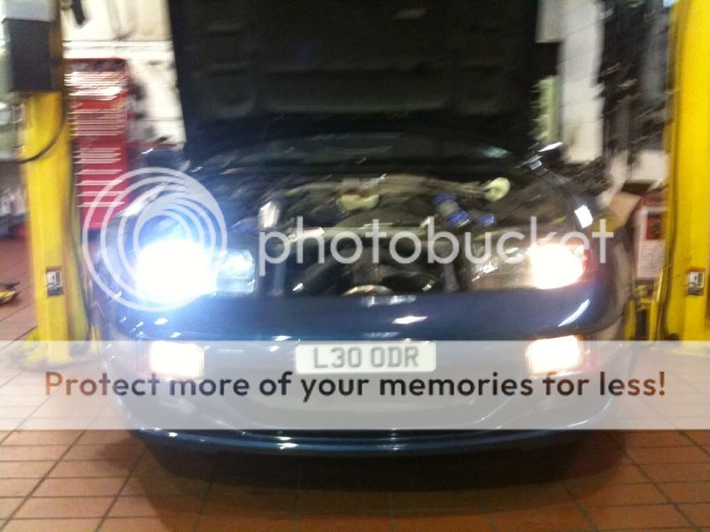

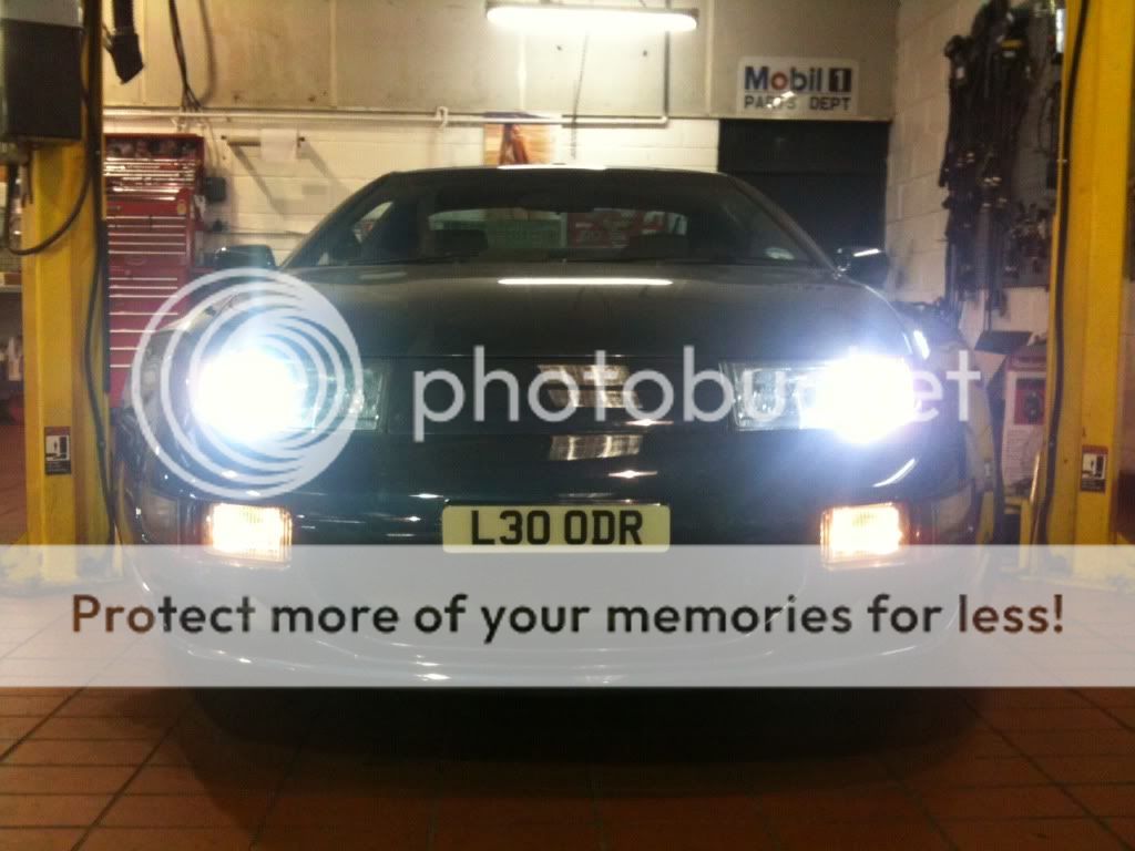

Fitted my HID kit today
Finally got round to fitting my HID kit after over a year of them sitting in my toolbox! :blush:
Got them from DTA - very nice kit & results look good so far - must go out at night to try them!! :biggrin:
One HID fitted vs standard lamp:
both HIDs fitted:

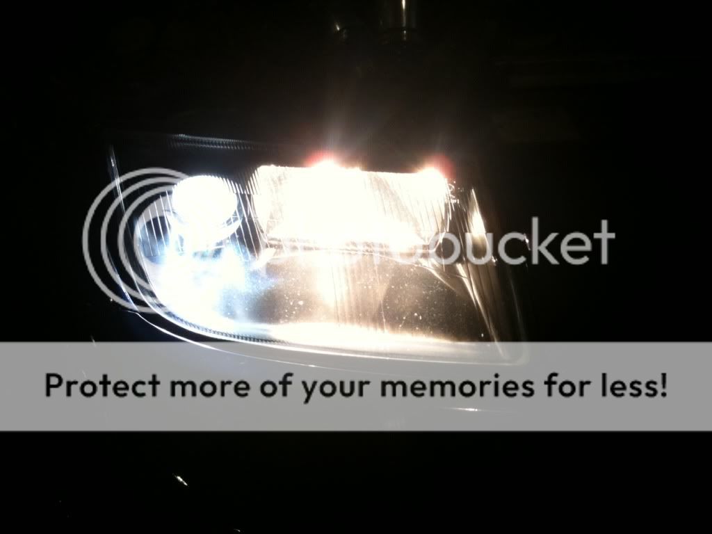

quick update:
got round to doing the high beam mod today - a must for anyone with HID's
link here to our FAQ section: http://www.300zx.co.uk/forums/showthread.php?t=117007
As standard on a zed the dipped beam headlights will go out when you switch main beam on or flash the headlights - not good for the HIDs or for light output as it takes a short while for the HIDs to come back on.
With this mod carried out it keeps you dipped beam (HIDs) on when you switch your main beam on. Also when the headlamps are off it will just flash your main beam & not affect the HIDs to switch them on as some other mods will do.

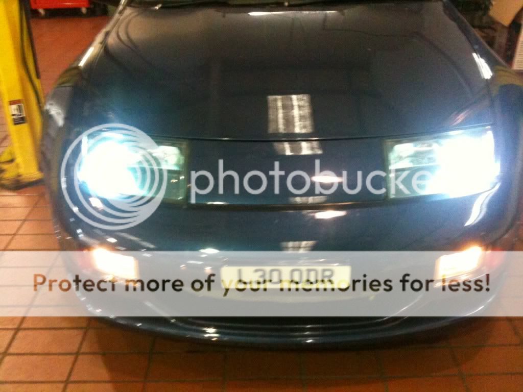

Heres a pic with the mod carried out - both lamps on:
Look great paul. which kit did you have, was is the 6k?
yes mate - as supplied by DTA. Also had the 6k main beam bulbs too.
