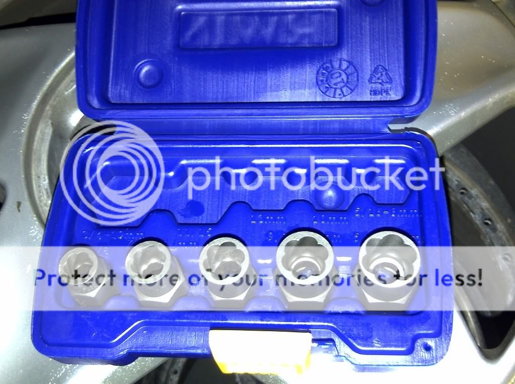

Success, at last the final head bolt is off and the full strip down can begin.
The Irwin 'Bolt Grips' sockets that were recommended by Jimmer arrived the other day and worked a treat

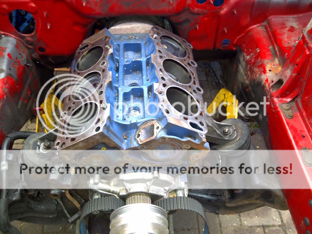

Glad they worked mate,knew they would.Ive got a bluepoint set and they are mustard for rounded bolts.That engine has stock gaskets !!are the pistons new ?

The pistons are supposed to be new but I have no idea if they actually are mate
I won't mention the zed specialist in question as my other thread is still on hold pending approval by the committee
so in the mean time I'm going to crack on stripping the block and see what I find

Pending approval,do they really think that "specialist" has enough money to sue someone then,i doubt it.How long has that engine ran for ? those pistons look rather black.
The specialist may have amassed a hell of a lot of $, I suppose it depends on how many customers signed up for £10k builds and recieved £10 worth of work and parts
The engine was fired up for the the first time whilst I was there, the total running time was about 2 minutes and then it went onto the back of a trailor never to be started again.
All of the pistons are as black as a witches tit (specialist technical term)

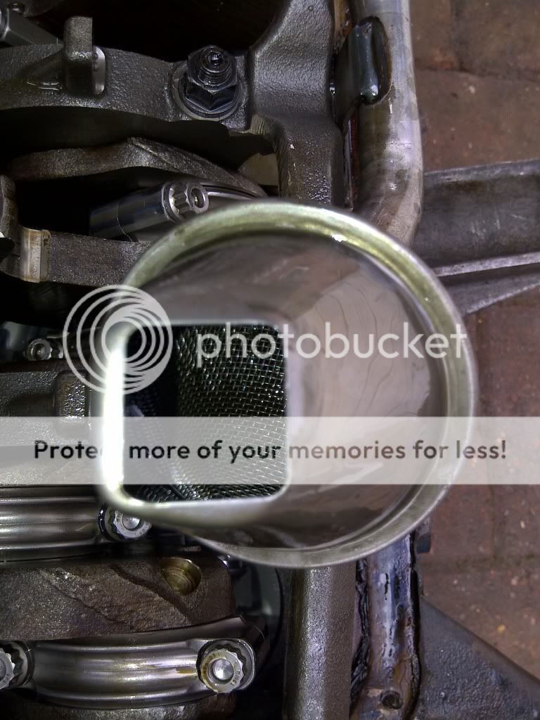

One thing that I have found since stripping the engine out is this:
why would there be small metal shards this side of the mesh and what might have caused it?

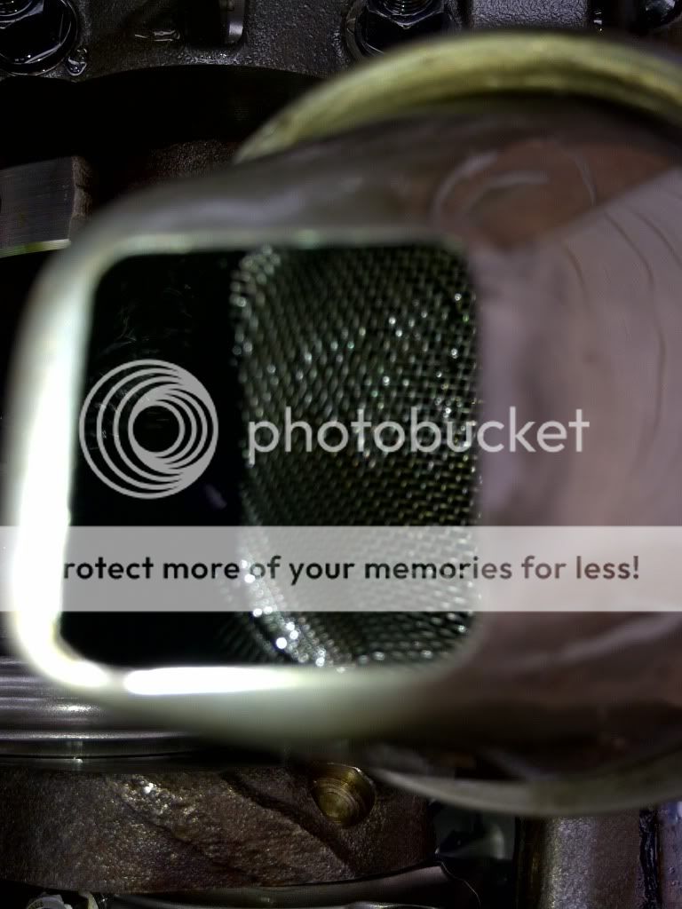

Its probaly poor engine hygiene,left from the last car it came off or metal that was left in the oil cooler after a failure.
