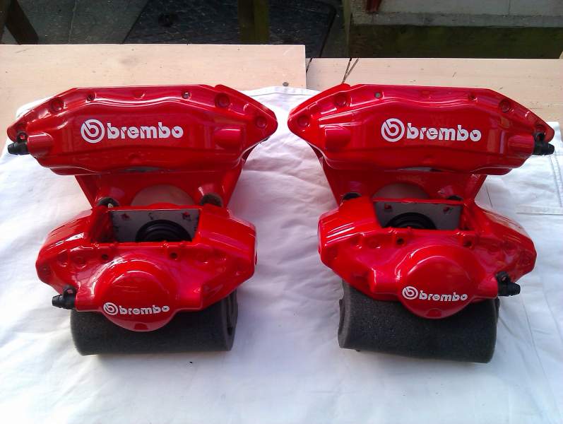

finally got round to taking the pistons and seals out today ready for the calipers to be powdercoated!:hyper:
dan.:cool3:
  • 1 month later...
helped out today to get the calipers ready for powdercoating, first two pics are after being dipped into the acid bath to clean off old paint and gunky stuff then washed off and last three pics are after they have been shotblast clean ready to be masked for powdercoat. :clap:
dan.:thumbup1:
Edited by dannzx
For brake discs have a look for a company called mtech, had them on last two track cars and they rock, also they are cheap!
  • 3 months later...

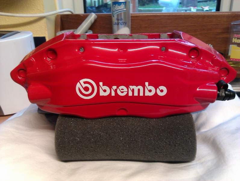

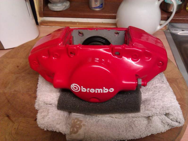

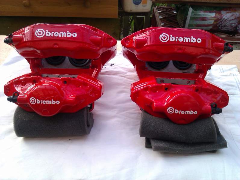

got the new seals fitted finally so now just got to get them fitted.
dan.:cool3:
Very nice Dan....... Did you get the discs and pads?
Alz.
Alz.
no not had the money at minute to get them but hope to soon.
All finished now waiting for next step! :thumbup:
dan.:cool3:
