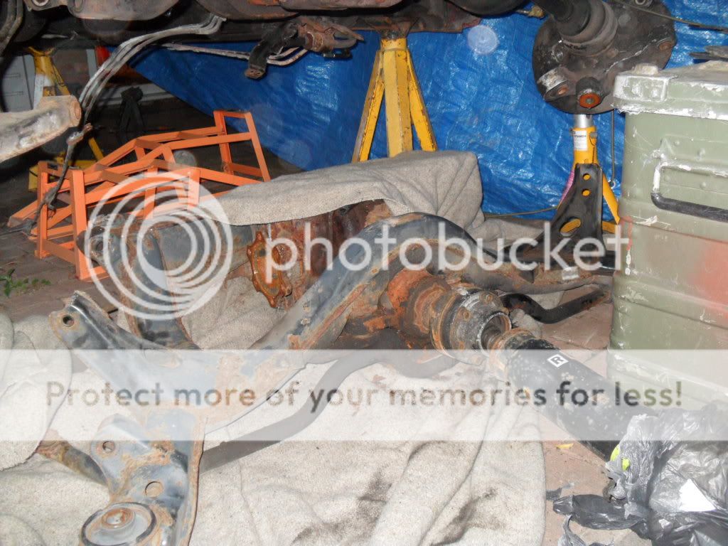

Removing prop????
Just trying to get the prop off the subframe but having dramas as it's still fitted to the subframe/diff.
I have a wreckers bar fitted with the correct type of socket/bit but is there a particular method for removing it as it rotates freely?
cheers fellas

from the pic it looks like the prop isent connected to the box so i dont think that will work????
Judging by the pic I would say it is connected to the car let alone the box :lol:
yes mate it is clearly connected to the car as it is still on the diff. come on steamy wake up;)
Could be just me but it looks like the subframe isn't connected to the car :)
Correct matey
Sorry should have made that clear in the first post. This is a spare rear subframe & diff that Big-Jim kindly gave me last weekend.
It's not attached to the car. I need to strip the prop off as that's for another forum member, the remainder will be sand blasted, powder coated and fitted with solid bushes ready for a one for one swap with the current subframe on the LWB.
I need to find some way of locking off the diff without damaging anything but really struggling at the mo'
you rough bugger. lol. yeah it will work allright at rounding the bolt out:rofl: you need a steady but constant force on it. lock the prop off.
