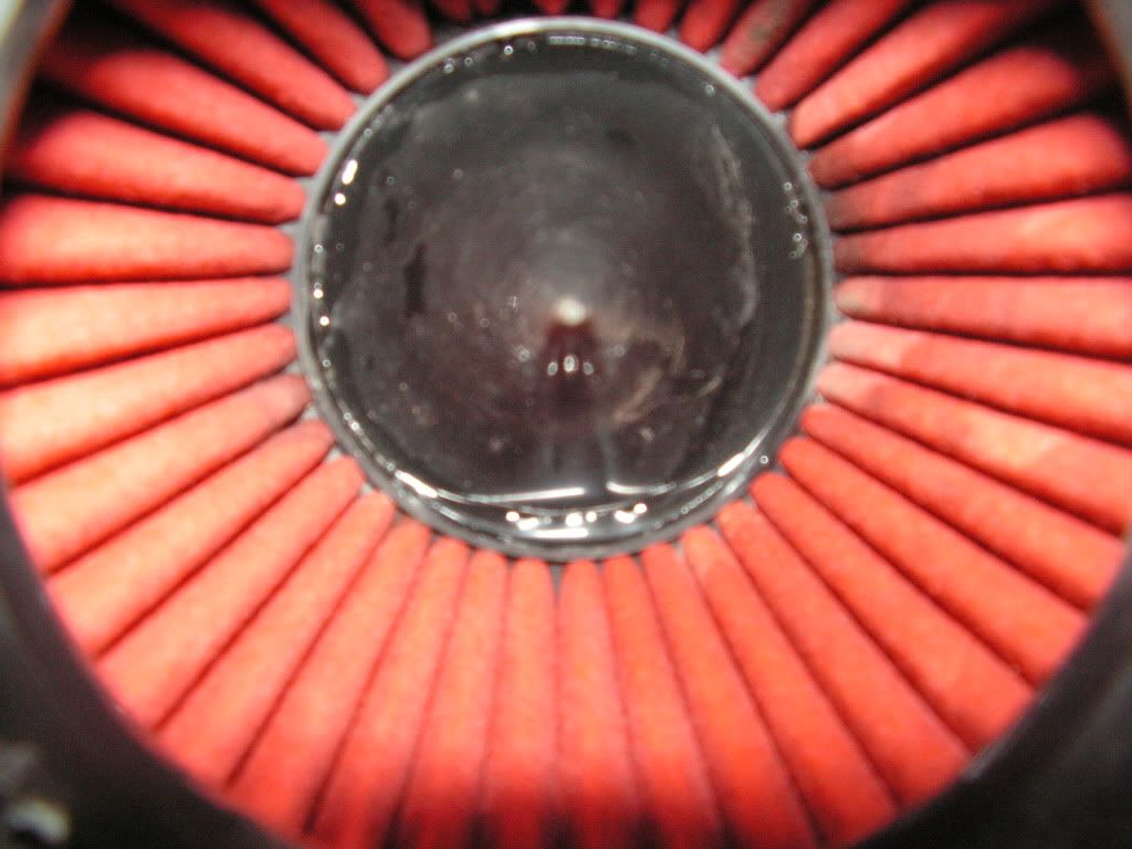

Today i found this in my filter
That was at the end of the run, i dread to think how much was in there at the beginning.
Its an apexi power intake, not a cheap one i believe. Can i clean this and are they prone to letting in water, or will that be the paper gasket used to blame.
Thanks guys
Mark
Yep, that can cause your problems. Take the filter AND maf off the car and put them in the house for a couple of days. It needs to dry out completely, should be fine once dry.

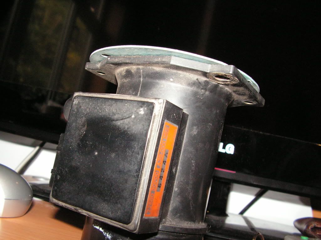

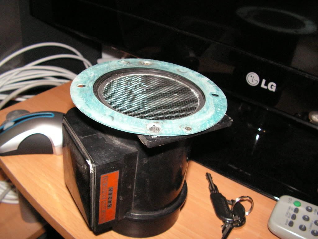

This is the gasket im talking about.
I really dont think its making a tight enough fit with only 2 bolts and it being circluar.
Ive got that plastic pannel underneath aswell, It only happens after rain or a wash.
Edited by vodkashots
Yeah that's not the right gasket for an apexi, it should be squareish on the outer edges and line up with the 4 bolt holes that hold the filter on. Unless you can find a proper apexi gasket, i would do as you suggest and seal it with silicon.
hmm, thanks, i had my suspicions :) This was on when i bought the car, i wonder why they didnt use the proper one. Looks like im on the lookout then,

Thats an apexi universal gasket which was normally supplied with universal apexi intakes, only the specific z32 cone came with the correct gasket.
Clean both surfaces and a wee bead sealant will do the job.

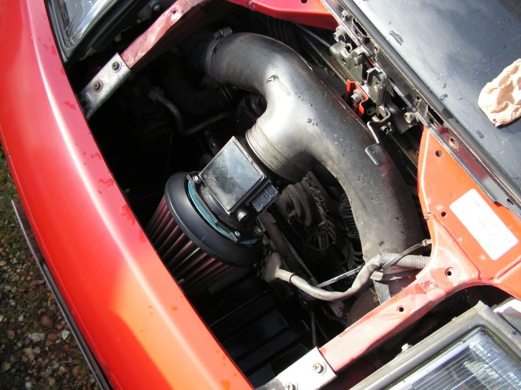

Just had a mini thunderstorm, the bonnet was on the latch but there is a fair bit of water on the plastic at the bottom
looks from that, that the rubber seals on your nose panel are failing and letting water drip onto the Airfilter, well thats what im thinking anyway.
I tell you what, ive got my bonnet on spacers and it brings the front down slightly further that before now. That might not be creating the seal. But im sure it was doing this before i raised the bonnet aswell

Who likes my fix.
Water was falling between the bumper and nose pannel onto the filter (i done some tests with paper)
So ive just cut this sheet out and put it over so that any water getting through now will fall around the filter.
Hopefully this wont affect the sucking power of the filter, but it seems to have cured it.
Looks like you've found an issue, but your also missing the plastic piece that should sit under the filter to protect it from water coming in from below. Quite common for people to mistakingly remove this when they fit an induction kit.
This is how my car came, i bought it like that, Whats the bit im missing, what does it look like?
Like a sheet of black plastic, about the size of an A4 piece of paper, and would normally sit just under the stock airbox. Very simple to knock up something similar.
The jolt you were probably experiencing was the safety rpm cutout at 3000rpm, thats controlled by the ECU when its not getting an appropriate signal from the MAF.
