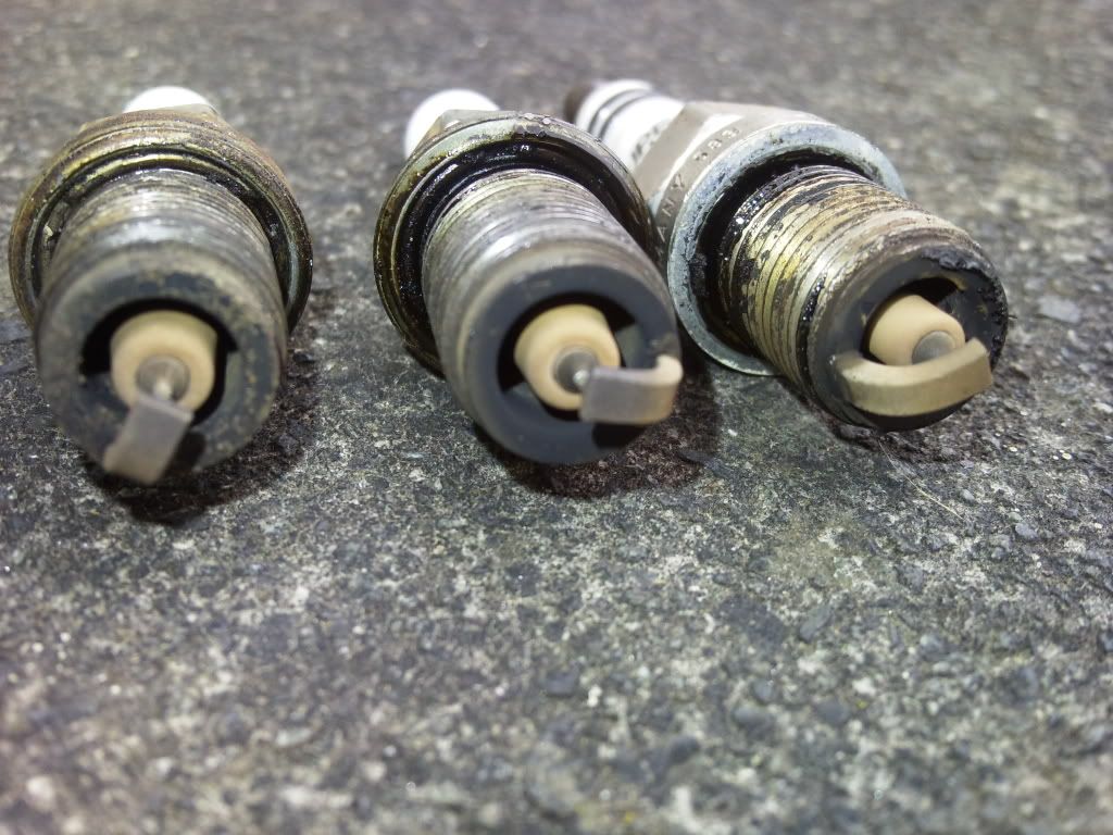

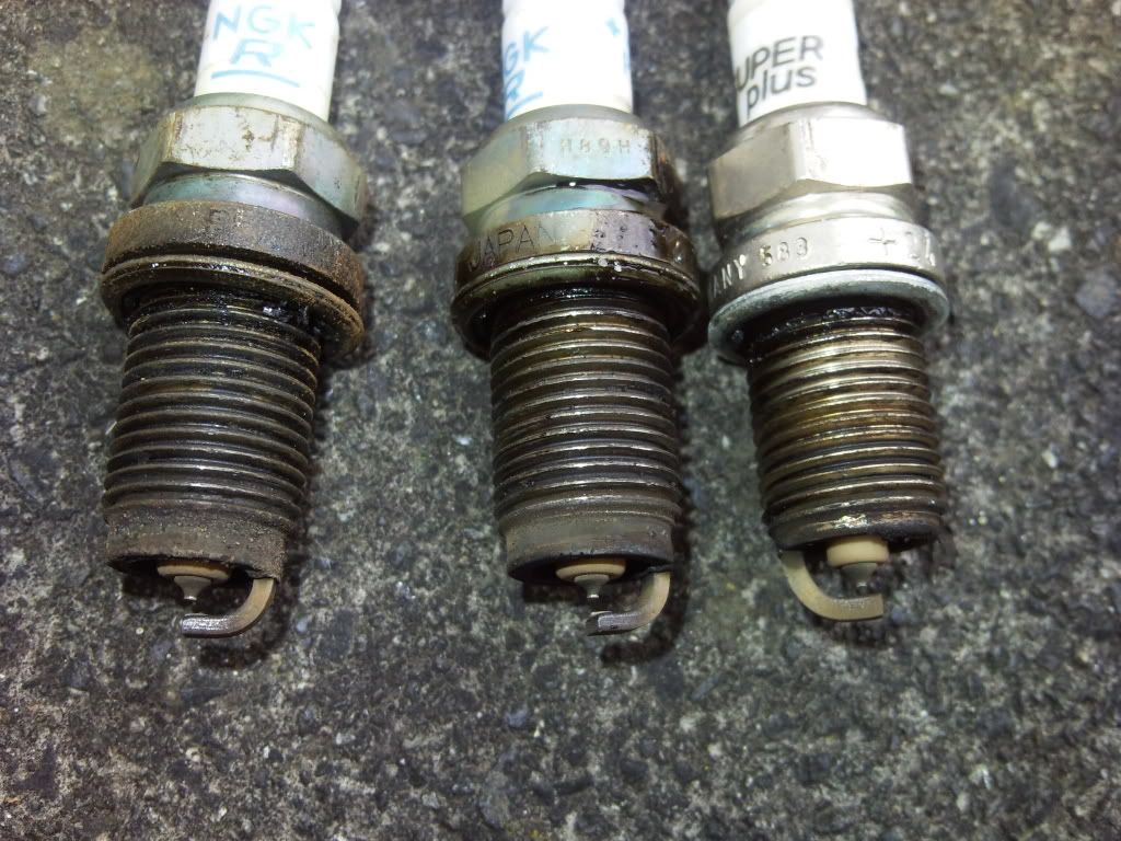

On a whim today, I removed three plugs (two NGK and one Bosch) to check on their condition (see photos), obviously I don't know how long the three plugs that weren't changed in 2008 have been in the car.
Looking at their condition, do you think that a new set of plugs is in order and again looking at their condition, do you think that the engine is running ok?

The one on the right is a wrong plug......
I'm guessing that that's one of the three which were replaced in 2008.
yep, not a long enough reach on that bosch plug (doesn't sit into the cylinder far enough to be fully efficient), get yourself a fresh set, at least you know they are nice and new then, or, if on a budget, just replace the bosch's with NGKs, but I would go for a fresh set TBH... And with a bit of luck, you may find it will help your dodgy idle too... Whoever did it has put in "equivalent" spark plugs that are incorrect...
I would stick six new NJK's in and as Tony said the one on the right is the wrong plug!
Yup - I agree with Gary and Tony.....
.....always keep to the original spec plugs IMO!!
