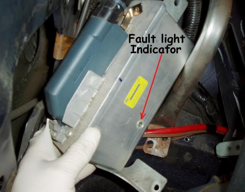

The ABS system fitted to the zed has a very easy to use built in diagnosis so there is often no need for any specialist equipment. The self diagnoses is built into the abs ecu module and the ecu has a small led that flashes a set number of times to correspond to a particular fault code that is stored within the unit.
A small drive is all that is required until the ABS warring light comes on and stays on, by pulling over and leaving the car running the latest fault codes can be read, the codes are limited to a maximum of 10 separate codes but then the system is relatively low tech, incidentally the most common fault by far is one of the front wheel sensors

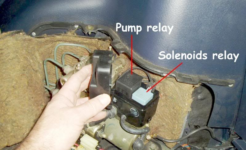

Initially we went for the obvious and did a built in diagnostic code check, the led light was flashing 9 times, fault 9 relates to “ pump relay contact” so it made sense to change the relay.

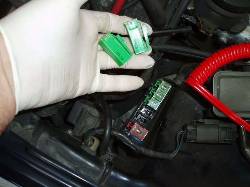

So following the change of relay a quick test drive revealed the fault was still present , so all the fuse were checked again, the two in the small fuse panel by the brake master cylinder and one in the fuse box by the n/s headlight, all were ok.

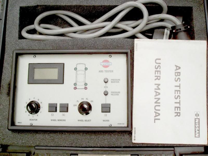

With no more to go on it was time to bring the big guns out, well a genuine Nissan 300zx ABS test unit from 1990 no less.

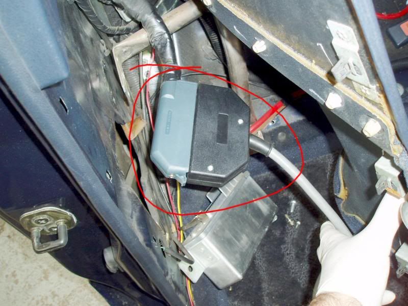

The unit requires the abs ecu to be unplugged and the unit takes the place of the ecu, from here all circuits can be check in a matter of minutes.

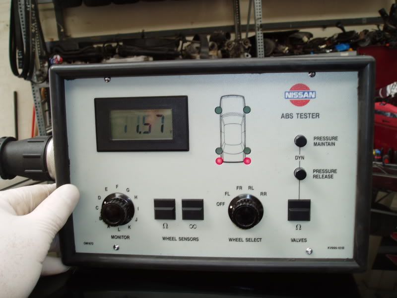

The Nissan tester unit has a series of tests you need to do in a specific order and during this a failure was detected with the pump relay, remember the original self diagnostic check said the same, this had been changed so could not be that.

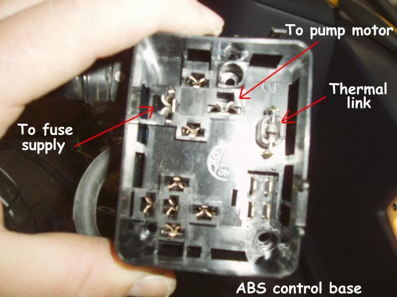

The Nissan tester goes a bit further though than the built in test in that abs pump can be activated from the tester but it was not responding and the display screen showed an inverted voltage across the relay contacts, the pump was disconnected electrically from the relay base and a temporary supply direct to the pump and it ran perfectly

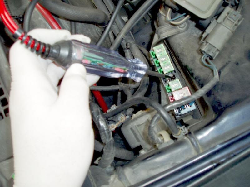

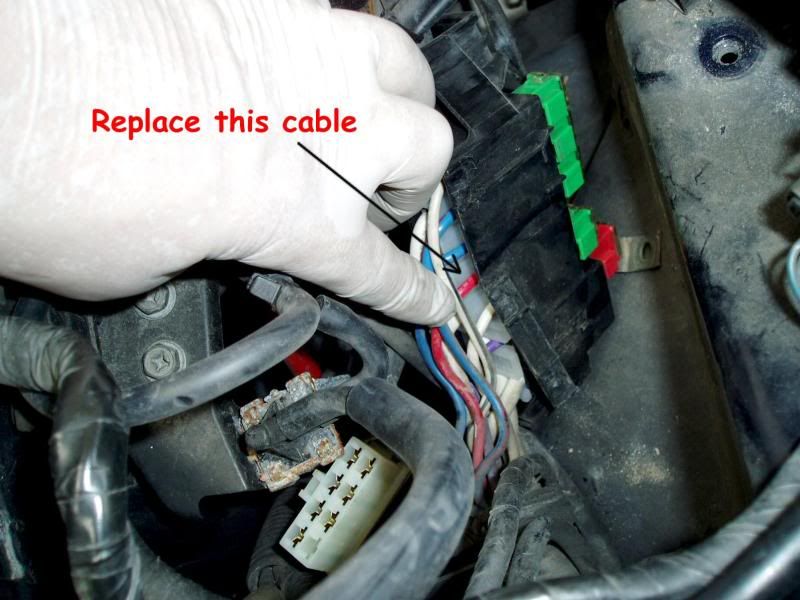

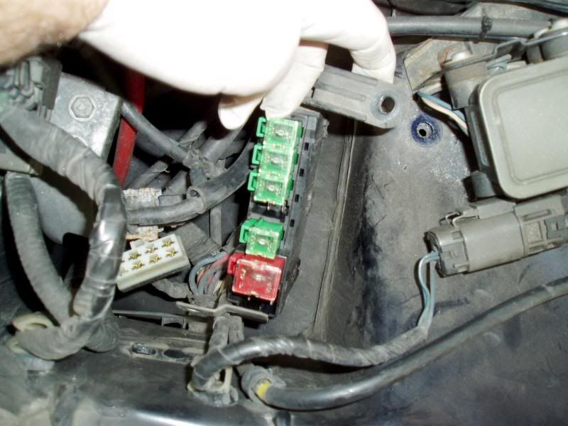

Back to the fuses and all good and supplying 12v+ to the outputs of the fuses, strange, with the pump relay removed and the ignition on the relay base contacts were checked and there appeared to be a missing live supply on the pump supply.

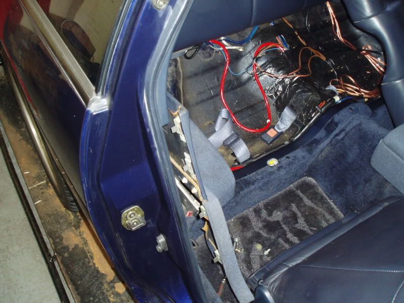

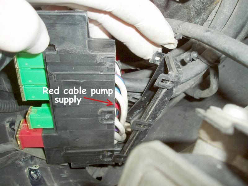

So then it came clear a cable fault between the relay base supply fuse and the relay base existed, with a few zillion miles of cable loom to unravel it seemed more prudent to just run a new supply from the original fuse location to the pump.

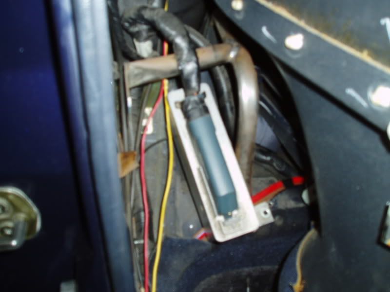

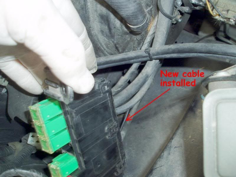

By running the cable through to the original fuse location we could use the original circuit breaker and so looked original and would be a long term repair, the only issue here is the fuse box cables are only accessible from below it and the supply loom is very short, by undoing the fuse box fixings and rotating it the lower cover can be removed to splice in the new cable.

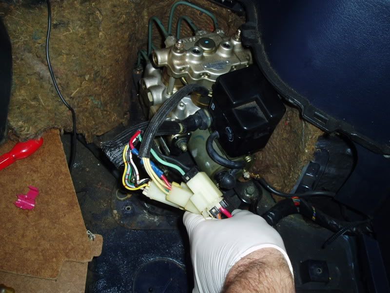

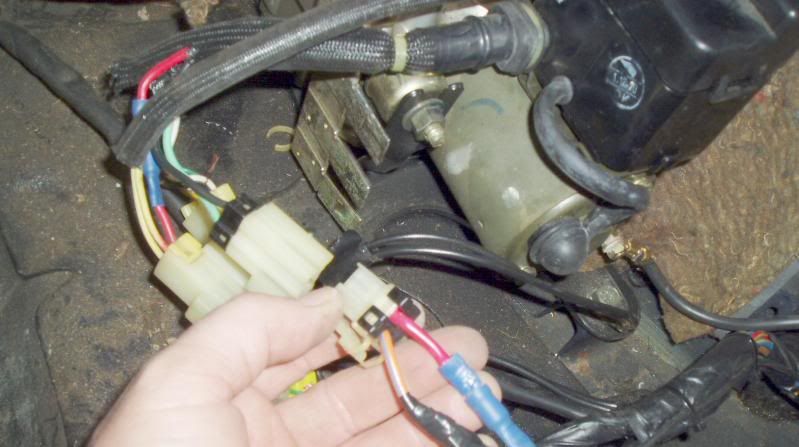

Once the cable was run from the fuse box to the loom at the boot abs unit a secure connection could be made there, as can be seen below, the red cable with the blue connector
