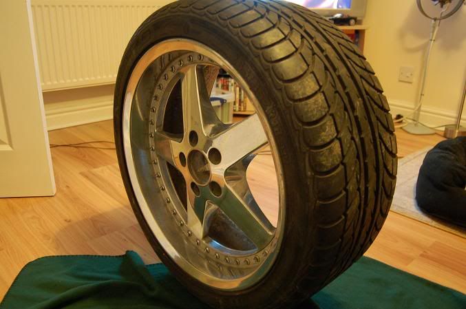

Whilst respraying the zed, i decided to sort out my wheels...
£20 polishing kit off ebay has worked wonders!!
What sealant do i need to use to seal the split rims though??
nice finish, what kit did you get in the end, that looks a fantastic shine, id use tiger seal to get the bond together, plus it can work up to high temps as well and should leave no gap for air if a continuous bead.

I have always used silicone mate,clear is best-put plenty on,bolt em' up and trim the excess when dry.:wink:
Nice one, cheers for the comments & help.
Yes that sure is in the living room - when your garage is full up with the rest of your car you have to move into the house!
With regards to the lip...its polished up nicely - do i need to spray a layer of lacquer on to protect the metal?
