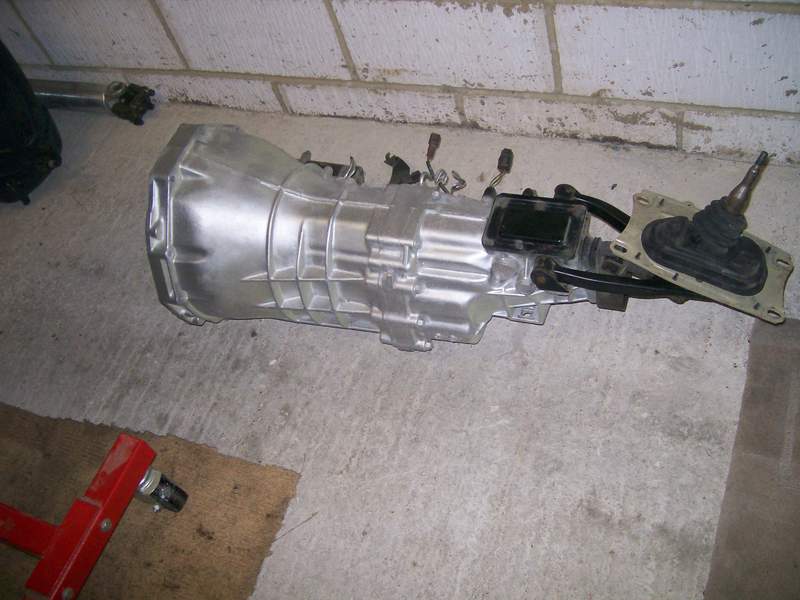

Manual box

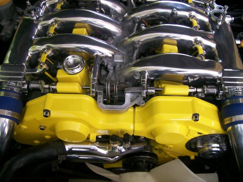

Engine with most of the parts back on and the throttle cover finished.
Engine ready to hoist in, we fitted the gearbox before we put it in the car and i have never had a grear box go on so smooth and first go. Must have aligned the clutch plate perfectly lol

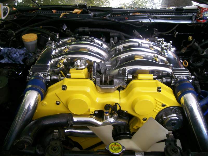

Well nearly finished, got a couple of bits of wiring to do, fill with water and fit the clutch hose, then fingers crossed.
Here are some pics of the work done today:
One piece lightweight prop
and the rest of the engine bits
Tidied the temp sensor wires and re routed and relocated the PTU under the headlamp panel, to make it look cleaner.
Going to replace, some hoses and clips with new once ive got it going again.
