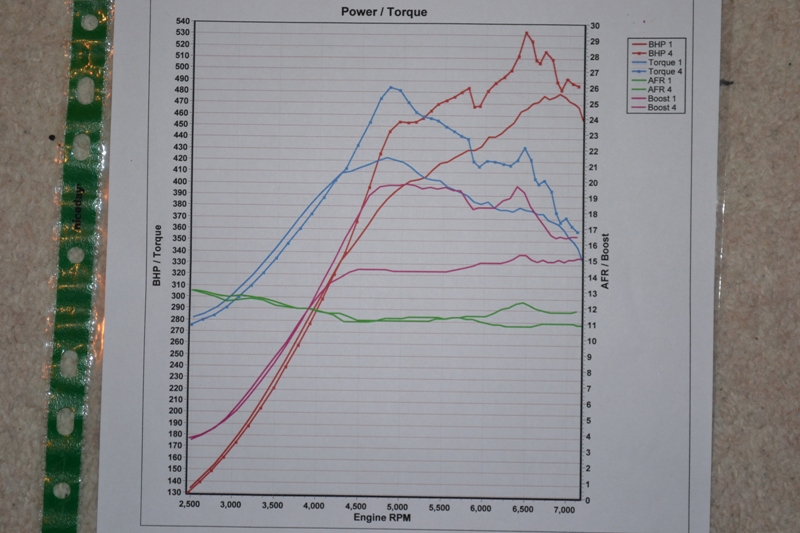

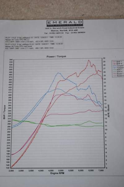

Prior to going down i thought my fuel pump was going to cause me issues and unfortunately my uprated one did not arrive in time for the session so it was still running the stock pump. When i got back Dave said that it was struggling to get fuel towards the top end and it was down to the fuel pump.
He set up a couple of different Maps for me to run as you can see on the Dyno sheet. The revs have been limited to 6200 until i get the new fuel pump installed. He has installed a 3rd Map that has the uprated fuelling map on it so i can change over to this once the pump is installed. I had no idea what boost levels the turbos would be able to produce and safely run and i thought he had set it up for only 15PSI but looking at the Dyno chart it seems to be a map at 15PSI and one at 20 PSI. They are GT675RS turbos and after a bit of research i think they can handle a few more PSI but i am happy with what i have just now.

Glad you had a good day down there Bazz, Dave really is a top bloke. Once you get the fuel pupm sorted we can even out the boost dip in the higher boost setting which will remove the torque dip too.
Full throttle shift is ready to go but you need to fit a clutch switch as your car didn't have one.
