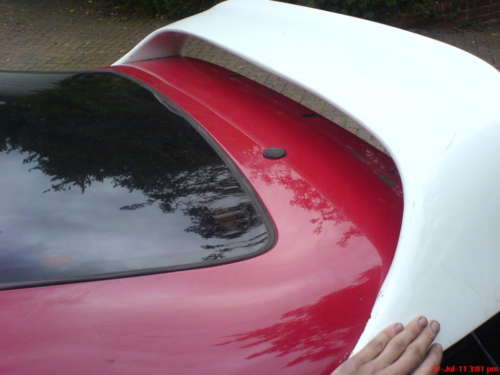

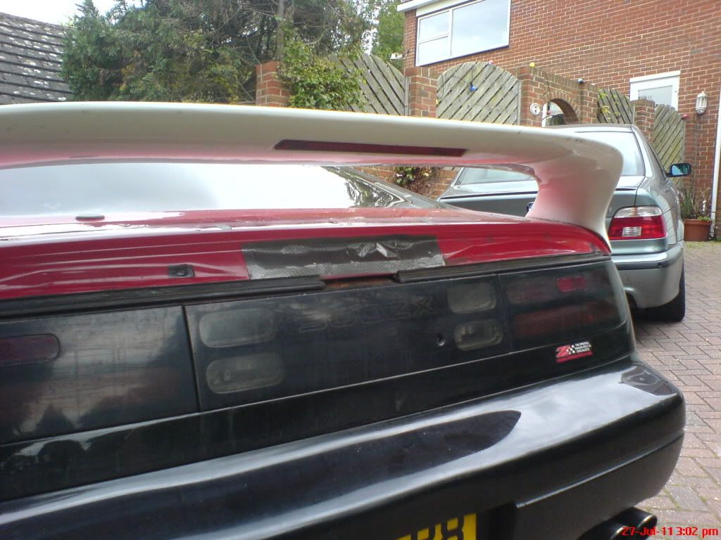

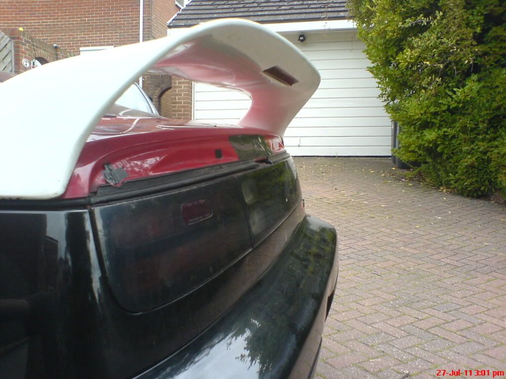

as title really, since my decats are not here yet i got bored and attacked my '89 spec spoiler, well it came off, took alot of paint with it lol, glad the cars getting painted/ wrapped soon,
i need to get a perspex strip, do they cover the brake light hole?

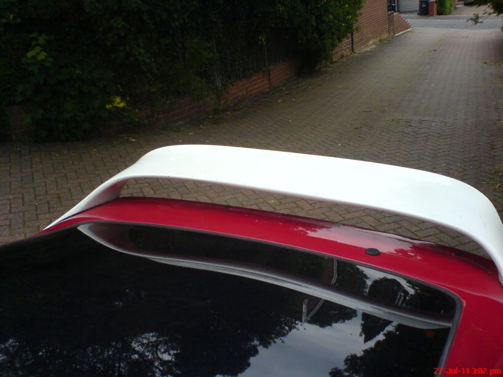

got a mid level spoiler in my garage for a zed but dont know how i would attach it? any ideas their is no way to bolt it on as couldn't get to the other side anyway.

yes, perspec strip covers the brake light hole
You want something like tigerseal or sikaflex
i used tigerseal to attach my 89spec, but according to jims forsale thread about the same 89spec spoiler, its hanging off? lol
Take off the plastic trim underside of the boot, stick spoiler on with tigerseal on top of boot and secure with some small self tapping screws from inside boot. Thats how i attatched mine on.
