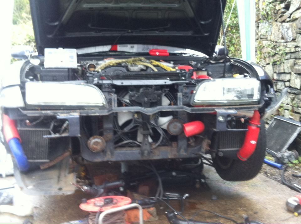

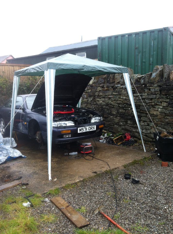

Bit of an update as managed a few busy days on the project, even got the gazebo out with the crap weather! so today I managed to...
Mount the P/S pump as it is on the opposite side to a 300zx
Fit the fans and radiator with metal brackets, 300zx oe hoses work!

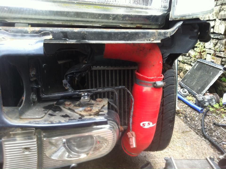

Mounted both 300zx intercoolers, can't go FM as need to put the intake/maf in the front
Mocked up the intake, intercooler piping on the passenger side

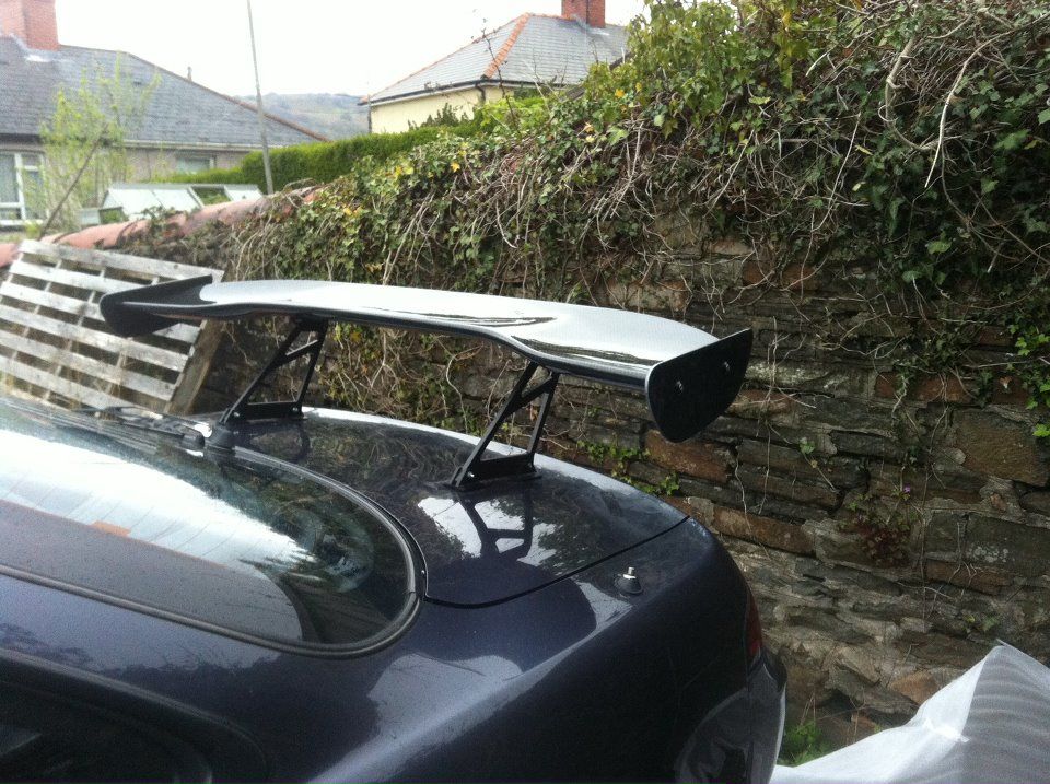

Fitted rear wing.
Pics below, enjoy....
