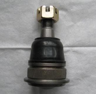

Hey, you may remember this thread. Anyway, I ordered the ball joint and I was attempting to do it today, but I cant get the old one out. I have the circlip off and the nut at the top, but I can't push the balljoint out of the arm. Any suggestions?
I've considered taking the lower arm off for easy access (unsure how difficult this is, should only be one bolt).

Ok, I took off the lower arm and removed it by hitting it with large hammer.
Thing is the saddle looks like its part of the old ball joint, it doesnt look like it comes off, but if it does, does it screw off?
Yes it does come off but it`s been on there a long time!! never had one be completely subborn but with air tools and ramps etc. jobs are so much easier for us.
Try warming it will a blow lamp and get you big hammer on it!
Jeff

Cheers! Though ordered one from Nissan to collect tomorrow...but if I can gstill et it off...
You say hit it, which makes me think it doesn't screw, its just placed on over the bolt section?
Not threaded just a tight taper fit.
Jeff
I should be able to hit it off then! :)
