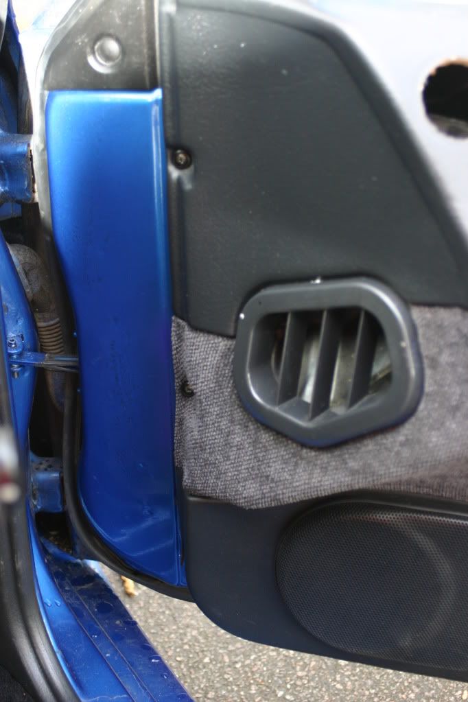

here we go

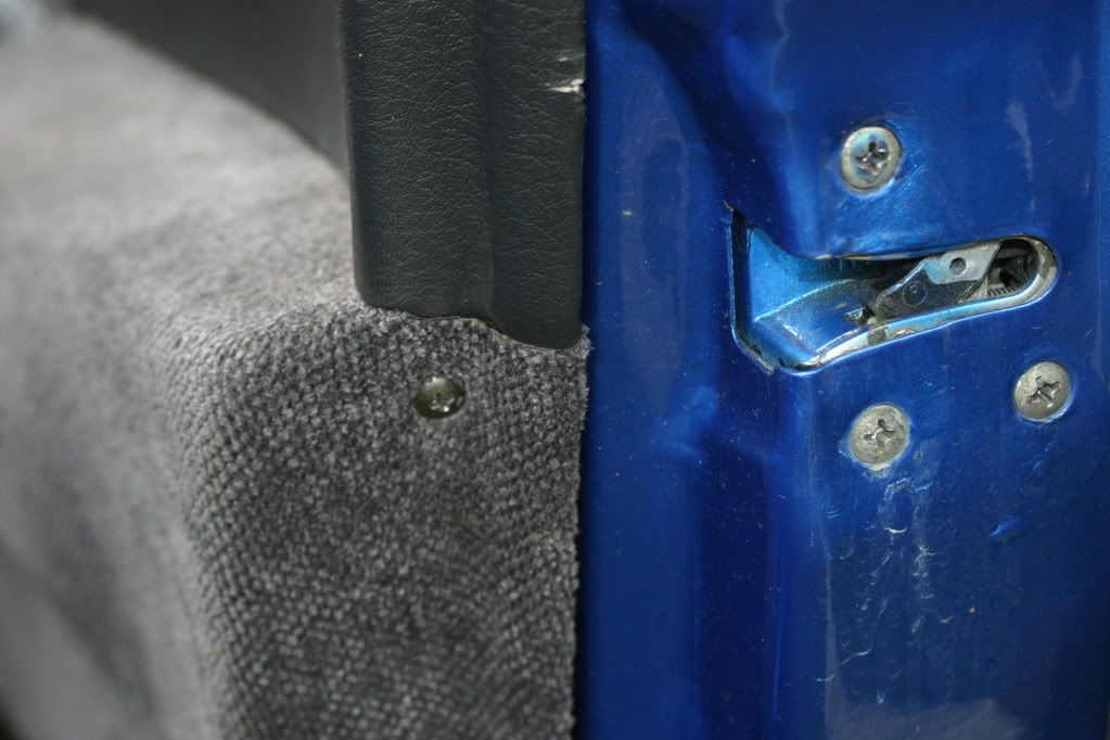

First unscrew these
One here (unless its japspec, then there is 2 more to undo)

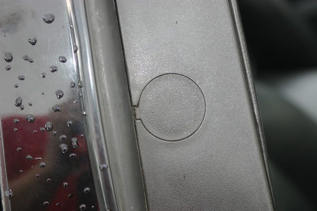

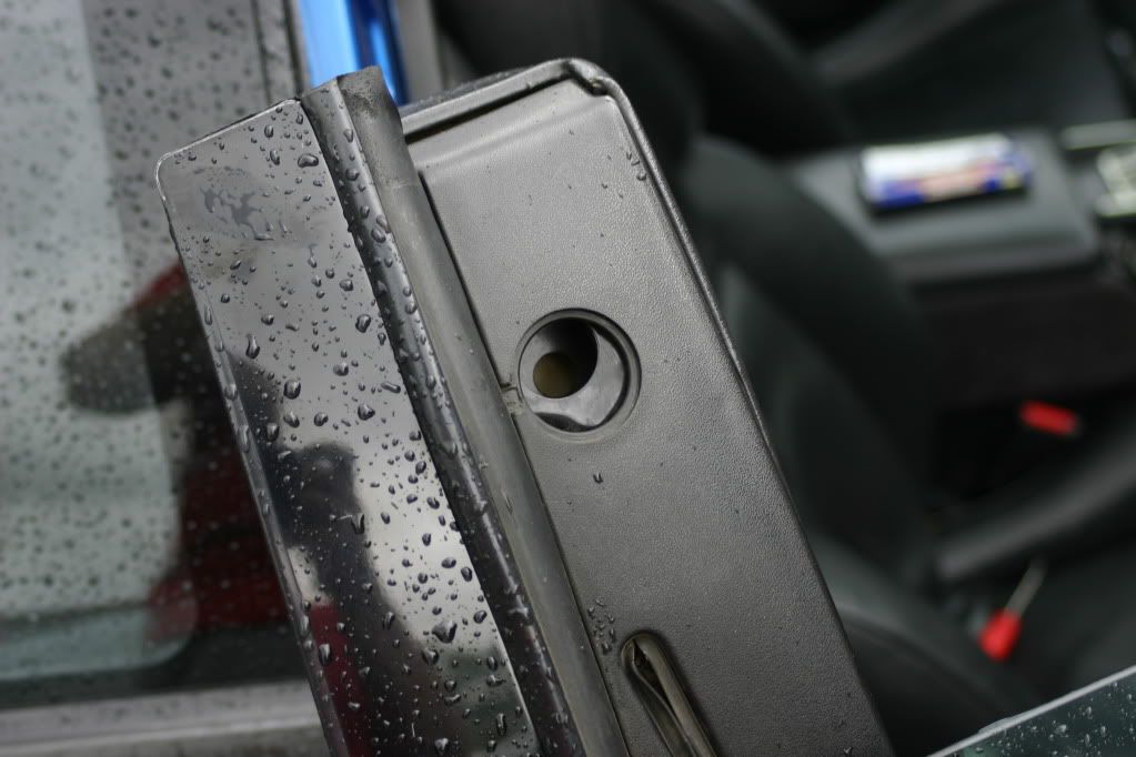

with the window down, you have this
remove the cap

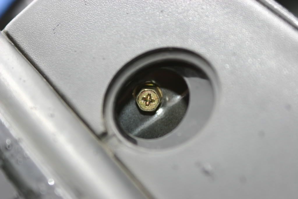

to reveal the screw with in

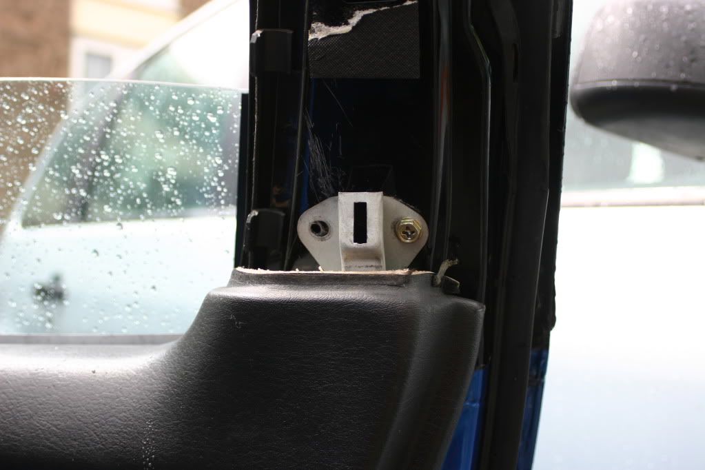

Remove pillar trim, to reveal 2 bolts (seen here with one removed already)

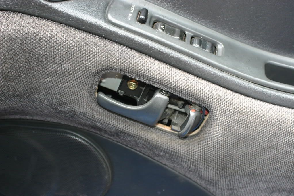

remove the 2 screws in the window switch door handle and remove to reveal one more screw (screw not pictured as its been removed already)

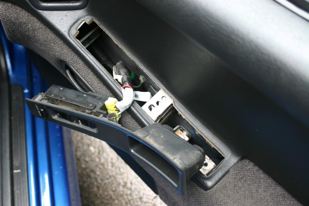

Take the door handle surround off
