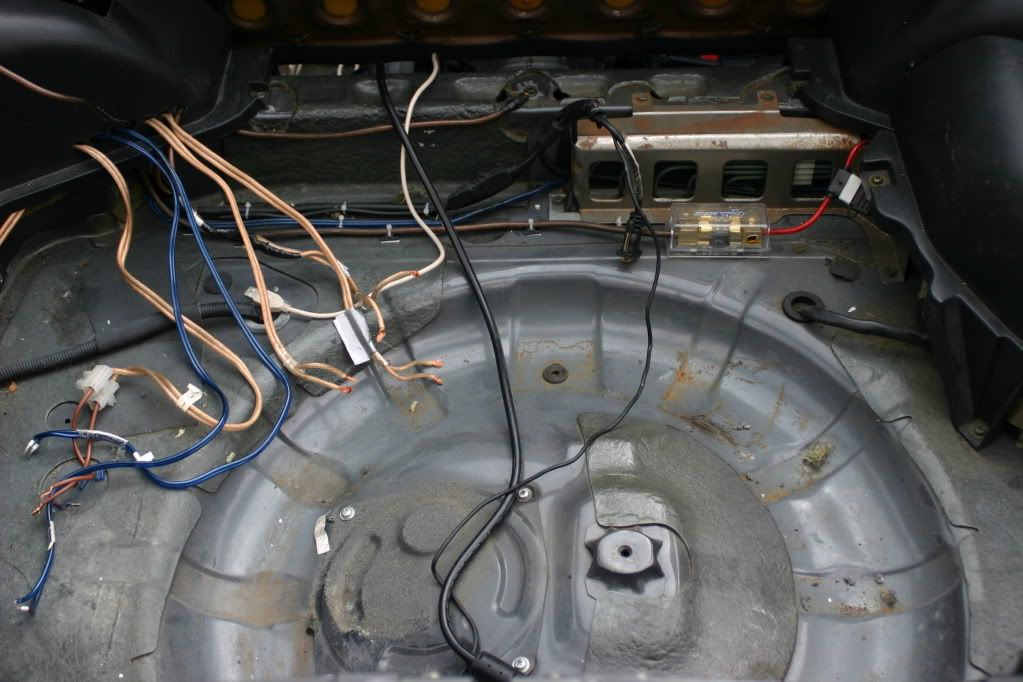

Its been a nightmare rewiring everything. but in short i went from how i got it, which was installed like this. (wiring was a little to be desired when i started delving deep lol)
So first thing to do was untangle the mess of wires, remove redundant wires that for some reason has been channeled in but did nothing and went from no where, to no where. until i ended up with this.

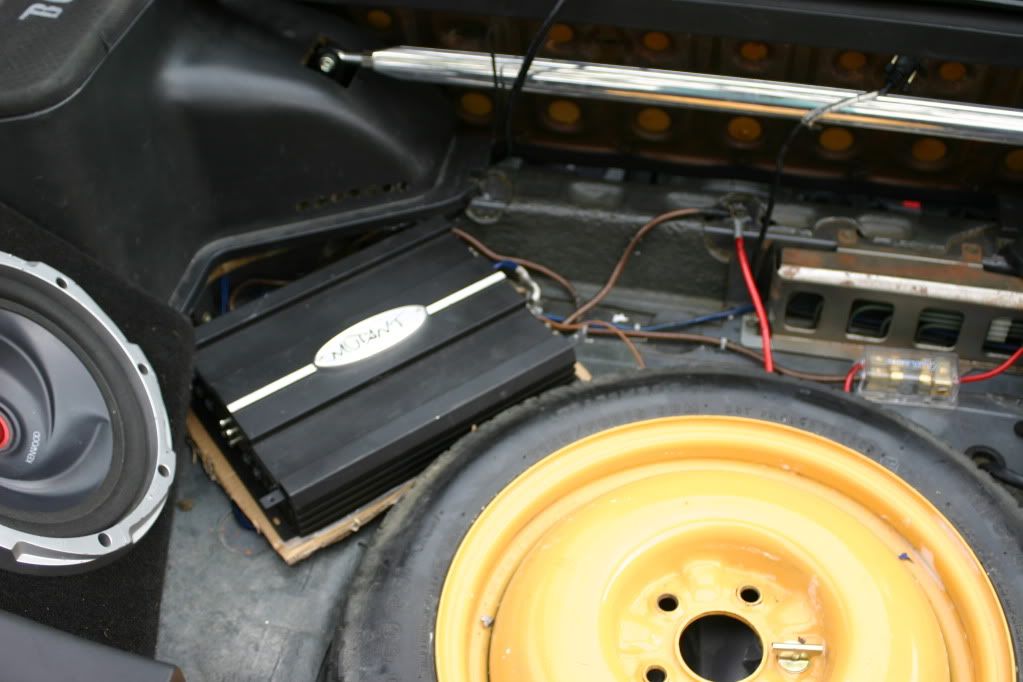

Then installed the amps under the carpet, hoping to tidy up the boot area, and hopefully also fit my spare wheel in, as it helps keep the carpets shape
So with one amp installed near the back of the seats, the other was installed where the tool kit goes.
Anyway, after a bit of rewiring, and hiding cables, and boot carpet installed, it looks some what like this.
