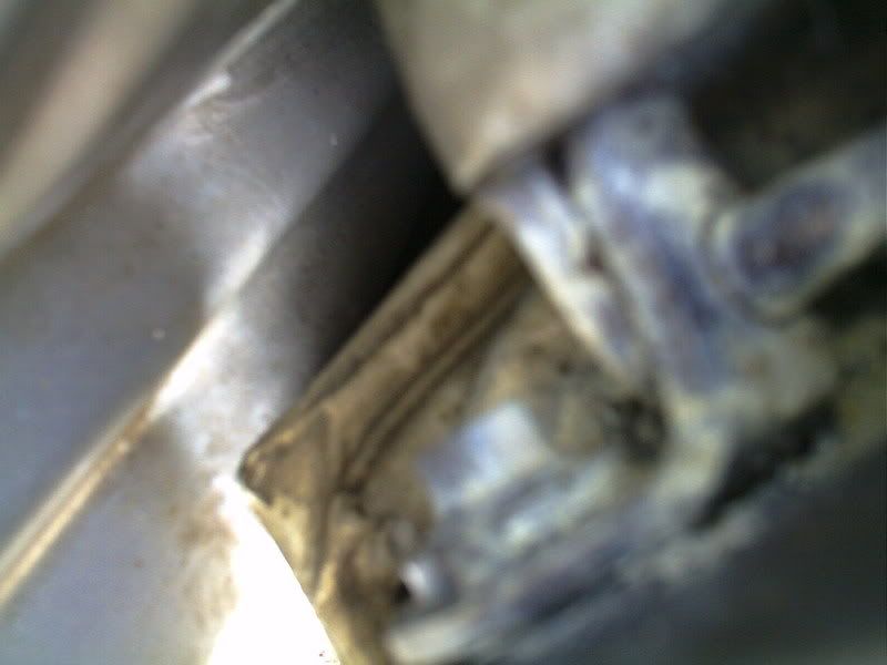

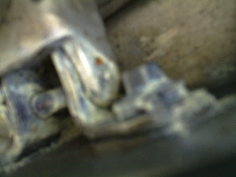

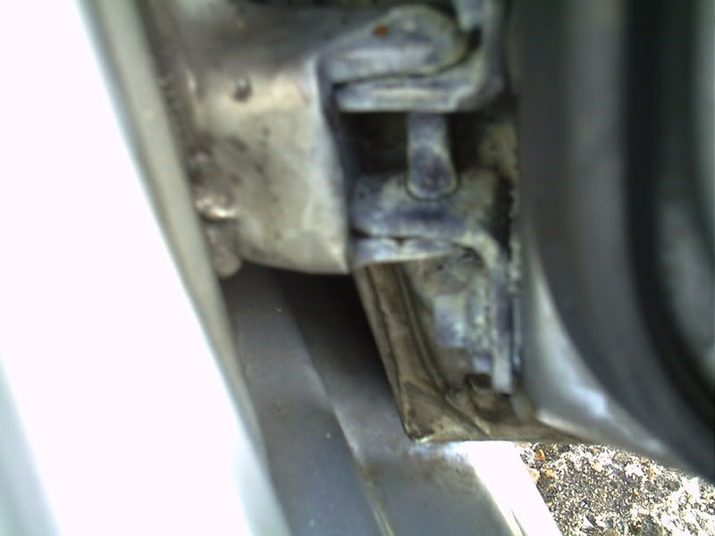

The way i did it a few years ago was to slip a washer between the lower door hinge and the door , remove one bolt , you,ll notice it has shoulders on the bolt , make sure the hole in the washers you,ll be using is big enough for this to go through , loosen the other lower bolt , put your knee under the door and lift it enough for a gap to open up and slip the washer in , put the first bolt back in loose and repeat on the other bolt , now tighten them up .
The thickness of one washer is usually enough to lift your door enough but if the hinges are really worn you might have to double up , only takes ten minutes and is alot easier than trying to move the upper hinge forward on the A post as it,s a real pain to get to the bolts . HTH
Sorry pics aren,t very good

As the bottom hinge has probably worn worse than the top all this does is put the door back to where it originally was , don,t forget you,ll be looking at the door gap when it,s closed after it,s been lifted onto the catch so the gap looks ok but as you open it it drops , it,s that drop that this sorts .HTH
