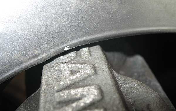

I fitted my wheels the other day, and quickly discovered caliper clearance issues on the front :(
I hastily popped to halfrauds for some 5mm spacers so I could at least get the old wheels off and new (too me) on, but even so clearance is tight ... maybe too tight ?
I got a cutlery knife in order to check clearance, and a set of verniers on the knife blade tells me I have 1.5mm minimum.
Am I right in thinking this is not enough ?

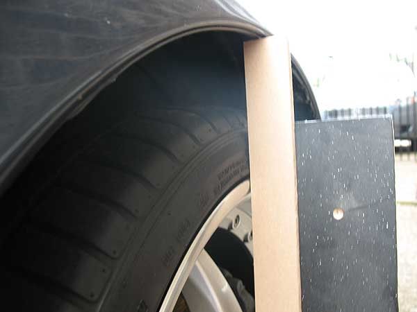

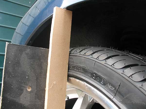

They have 8JJ with 35 offset stamped on them, but the guy who fitted the tyres measured the interior of the rim at 9" and when I put a straight edge flush on the tyres and up into the arches, the front sits around 5mm inside the edge of the arch inside edge, and the rear pretty much flush with the inside edge:
Front with 5mm spacer fitted:
Rear no spacers:
But can anyone tell me if the front caliper clearance is safe or not ?
It's not a sliding caliper and is bolted directly to the hub, my old wheels were that close with no running issues.

As close as 1.5mm ? It just worries me the rpm the wheel spokes will be whooshing past the calipers at when that close ! :scared:

You haven'nt got clearance problems. The wheels dont touch the calipers so no problem. you've only got a problem if they are touching and as you say there is 1.5mm gap.

Wheel design and incorrect offsett is the only real cause of issues with clearance.
1.5mm is very tight, however many have it without issue.

OK, Thanks guys :) I'll see how it goes, I will also see if I can get a 6mm spacer without coming off the spigot for a little more clearance ...
Ive seen simular on stock cars the Fiat coupes are just as close with Brembos. I had the same fear with my Brembos and my new wheels as i was told my calipers will expand with heat. If the Fiats work fine i dont see why ours wont :)
