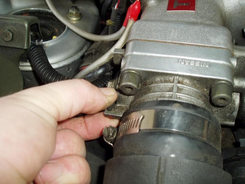

With your left hand firmly pinching the left hand throttle and stop .....

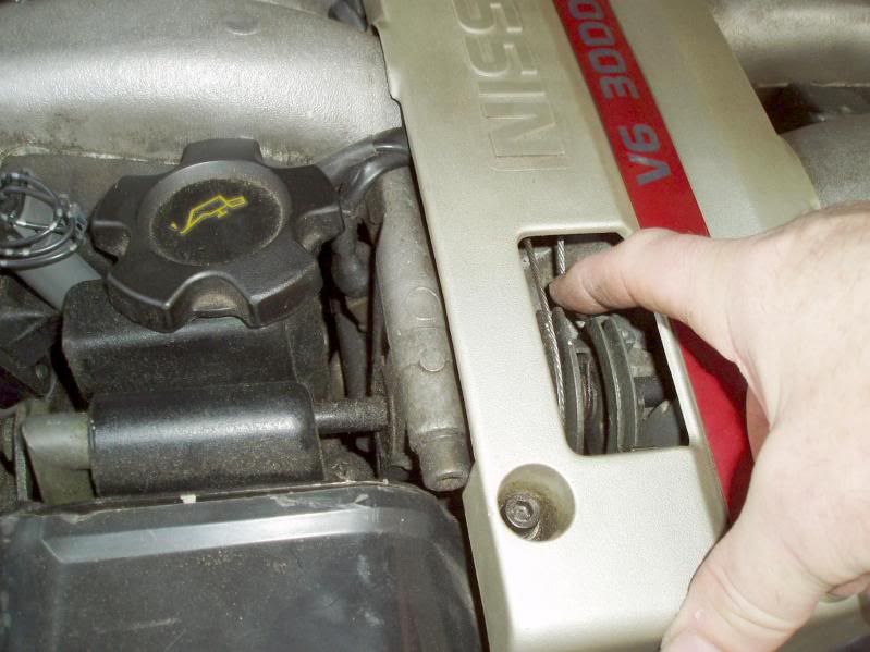

With your right hand move the throttle cable, not huge movement more of a slight bounce of the assembley..........

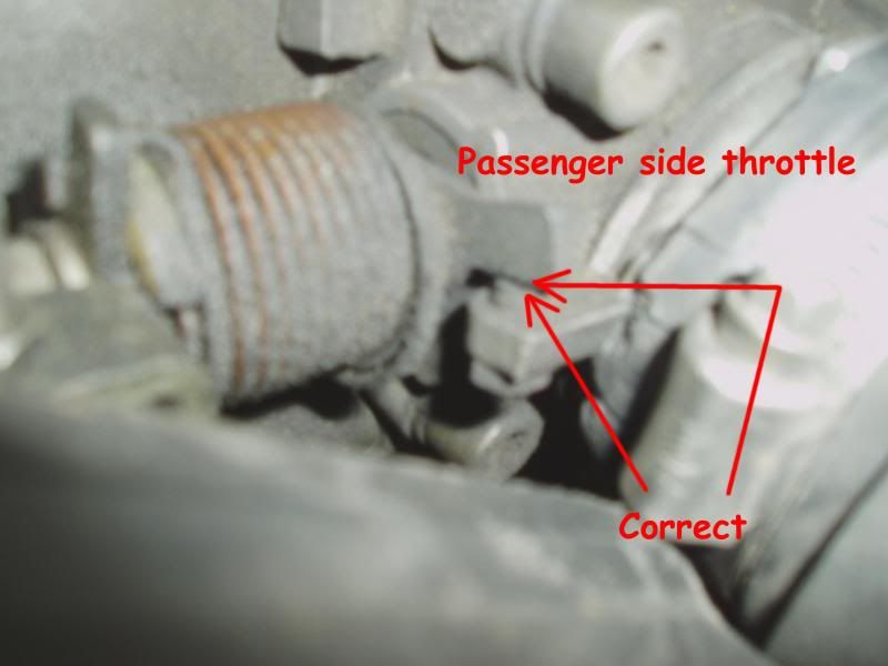

Whilst your left hand and right hand are busy (oh er missus!) look to the right hand throttle stop, if all is ok the throttle will still be sitting on the stop.....

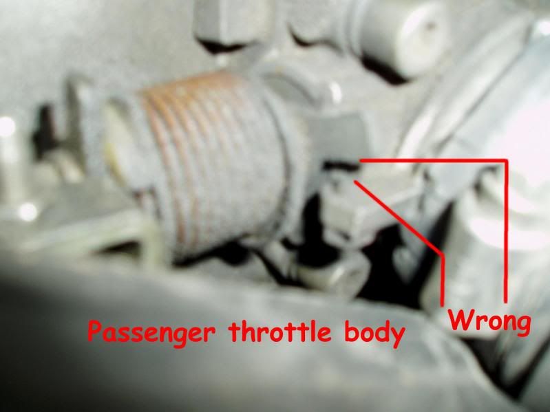

If however it is opening and closing whilst the other throttle remains held closed by your left hand you need to adjust the setting.....

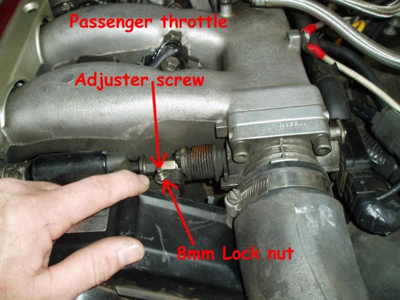

Here we can see the right hand throttle adjuster, loosen the 8 mm nut and then with a screw driver or by hand (usually easy) back off the adjuster screw (anti-clock wise) a full turn or so this will make the problem worse but its the way to do it, now slowly turn it back in feeling for it to just kiss the stop, refer back to the original test method ( both hands and eyes) and if ok lock off the stop nut if it need a bit more ( either way then adjust as required) once done nip up the nut and your finished.
